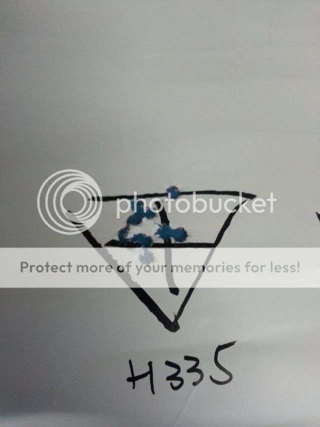

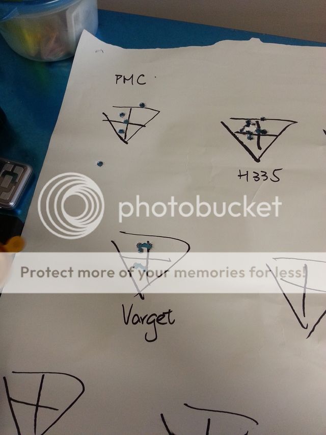

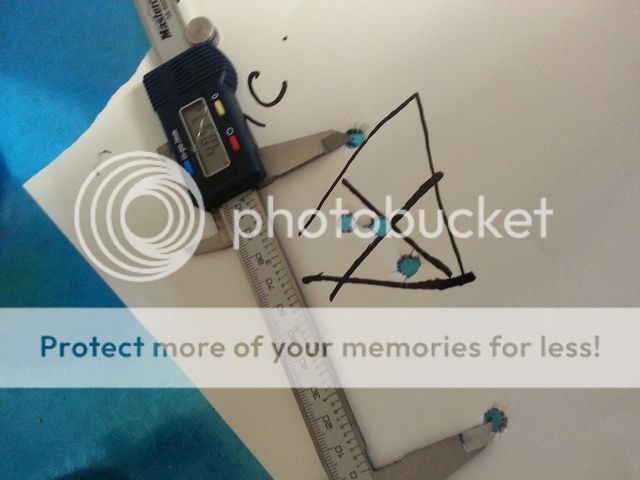

XCRM gas block/tube upgraded by wolverine. It loves hand load for sure:) and ppl with best shooting skill should be able to bring it to sub moa
100M
shooting with bipod and rear bag
my set-up
PMC 147GR(4.057)
5 rnds grouping with varget(1.071)
10 rnds grouping with H335(1 flyer maybe?1.390.5)
