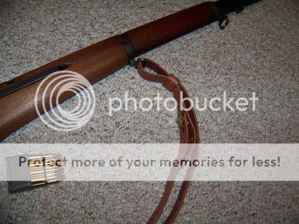

3) I bought a repro sling and mounted it now that I got the wood stock in place. It was different than any sling I have used before, can someone look at my pics and tell me if i have it mounted correctly?

The front sling swivel with sling attached:
The rear swivel with sling attached:

The short half of the sling should thread through the swivel and attach to the long part of the sling. You have got the long part in the right configuration though the brass hook attachments should be on the outside (so they do not scratch the stock and dig into your arm when using the sling for support).

So the sling is assembled correctly and just needs to be spun 180 degrees in the swivels? I wondered about the hooks, they are also very close to the top of my shoulder when carrying it with the muzzle up.

Yes basically it is set-up right...just extend the short strap to hook onto the long strap. One of the loops can be placed on the short strap close to the sling swivel so there is less play in the short strap, similar to what you have done with the long strap. The link provided by timberlord, shows the sling assembled.
