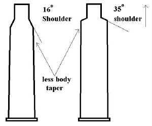

If you compare a 303 Epps Improved fired case to images of improved cartridges – developed by P.O. Ackley – like 250/3000 Improved (Ackley), 257 Improved (Ackley), 303-30 Ackley Improved, 30-06 Improved (Ackley) – from the ‘40s and 50’s – you'll see that there is a lot of commonality in the design philosophy. Specifically, like the Ackley improved cartridges, that came before, Epps adopted an approach of going with nearly-parallel case sides and a steep shoulder, angle leading to a relatively short neck.
These improvements, of course, led to increased case capacity – meaning that the cartridge could be loaded-up more, without exceeding the pressure limits of the relevant action.
It has been reported that, in his original interactions with Ackley, Epps suggested that he was interested in making these improvements to the 303 British case mostly to extend case life – by reducing case taper. This was based on the suggestion that reduced body taper lessens the rearward pressure effects on the bolt and lugs (bolt thrust). Sharp shoulder angles inhibit forward brass flow, which reduces the need to trim cases as often, whereas unnecessary case taper can lead to case stretching.
Epps’ specific solution was to increase the shoulder angle to 35 degrees from 16. At the same time, he decreased the body taper by over 50 thou.
