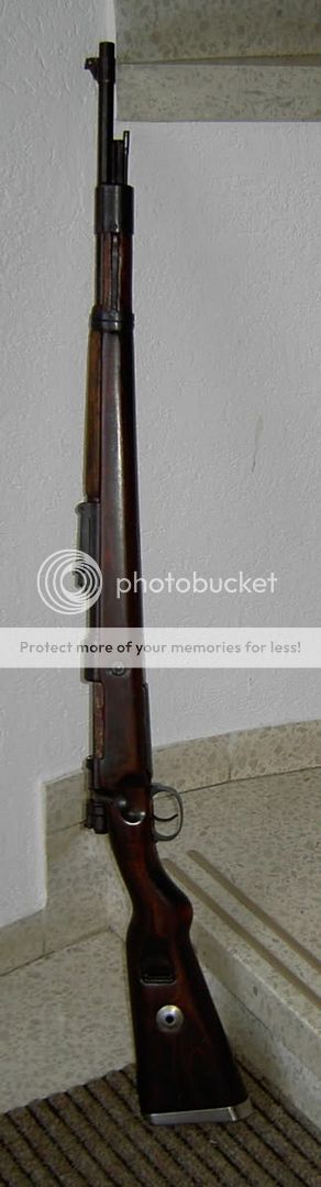

That's what I thought. A German made-Yugo capture. But I may be wrong. I was just wanting to see if someone could tell me just from the serial number, what original German manufacturer made this rifle. The serial number is A5225. I'll try and get some pics here.

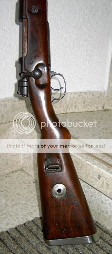

Not as far as I know. I don't have the rifle here. My dad has it right now. He couldn't find any. He said it still says Mod.98 and gave me the serial number (A5225) and he sent me these pictures:
Looks like a German K98 to me. The cleaning rod looks too short at 10" instead of the 12 inch one that it should have with a laminate stock.
I think your best bet in this case if the receiver has been scrubbed is to disassemble the rifle and look for any waffens. If you find any, check out this website, it will give you an idea on it's origins as far as manufacturer and when it was made:

No, but if you list the waffenampts and also take the receiver out of the wood and report on markings below the woodline we may be able to detective it for you.
Based on pics alone, it's a 1941-1944 made gun assuming stock is original to receiver. Probably an S/42 Mauser Oberndorf as they are the most common maker for those years.
