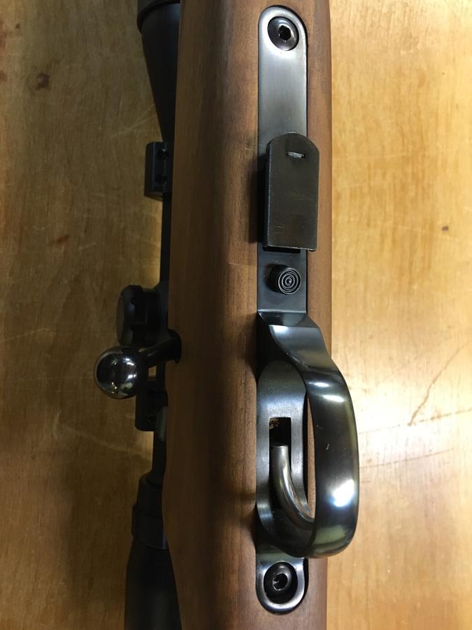

Just took mine apart to the bare wood. The exploded diagram does not match the gun. The bolt in front of the trigger guard is pillared(likes to fall out,the pillar). The bolt(?) behind the trigger guard came stripped. Mr Dremel had to be utilized (Crappy Tire cutoff discs useless , use Dremel discs). It’s not a bolt but a coarse wood screw. Removed the trigger guard and found a bolt and washer( not tight) securing the rear of the action. Now to start the striping process
Edit: By stripped I meant by the bit used to install the screw, no purchase for a bit or screw remover , a perfect circle
Going to look at mine... Can you post pics 45CAT?
Here’s mine...

Mine looks the same. The second action screw and washer are accessible once the trigger guard is removed.
Too bad bad about the stripped screw. My rifle was in great shape save for a small indentation in the wood near the magazine release.
