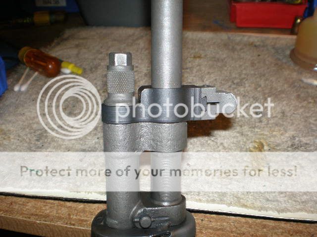

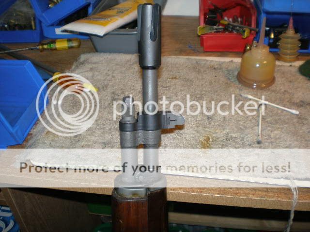

Mechanical zero for a Garand means starting with a windage setting that puts the index line on the back of the rear sight base at the middle windage point inscribed on the receiver below the rear sight base. The front sight is centered on the front sight base of the gas cylinder. Mechanical zero for elevation sets the rear sight aperture 10 clicks up from where it bottoms out on the receiver.

The mechanical zero will get you somewhere on the backer paper, or maybe the "bull", with the first shot held @ 6 o'clock on the "bull", and you can adjust zero from there using the windage and elevation knobs which have a value of 1 inch per click @ 100 yds. Sometimes the first shot from mechanical zero can be up to 8-10 inches from center of the "bull". In this case its best to zero for windage by loosening the front sight screw and sliding the front sight to one side or the other on the gas cylinder. There is an allowance on the gas cylinder for this. Taking initial windage with the front sight allows you to save the windage adjustments in the rear sight for shooting at longer distances.
