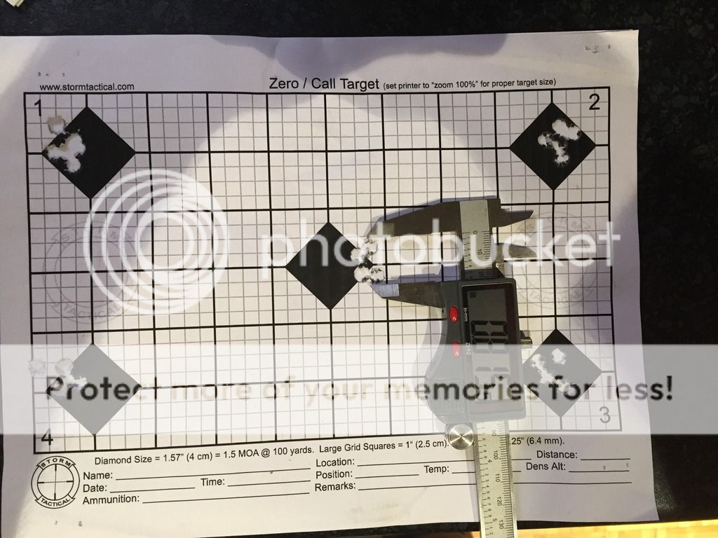

First time I tried this with my Sako TRG 22 in 308. Rifle has a Terje 12MM cheek piece spacer, is topped with an S&B 4-16 PMII ST in a Spuhr ST4701. Shot on the TRG bipod with a Red Tac rear bag. Ammo was Hornady 168gr AMAX match ammo. I have not done any load development because it will soon be headed to Insite Arms for a barrel chop and some cerakote.
Shot at the CDTSA Shepard Range. Wind was non-existent d the temperature was approximately -7. After the first string, the mirage off the barrel got pretty bad. The range runs east-west and the mid-afternoon sun comes pretty much straight down the scope. It all worked out though.
Group sizes were as follows:
0.710
0.705
0.532
0.668
0.694
Average of 0.662.
