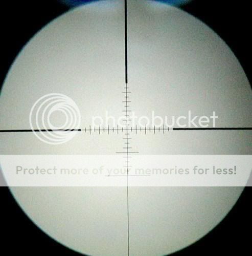

For the scope I went with a budget choice again. A guy on another forum I go to sells the Vector brand of scope. I know I know, cheap chinese scope ! I got it for 120$ shipped, it has a 4-14 magnification, and the reticle is what I wanted.
There is enough lines on it to learn to shoot by holding to the good one, and I plan to do exactly that. It is surprisingly clear for the price.
