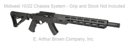

Howdy, I have gotten the itch for a 10/22 build. IPSC mini rifle seems to be gaining popularity mostly thanks to our ban happy Liberal overlords.
Starting to figure out what a potential build would look like (receiver / trigger / magazines / barrel etc etc) and it seems there are limited options with an enclosed forend (which I prefer after shooting long guns with a C type hold for many years).
Have only found the Midwest Industries version which CSC sells (has a 13" enclosed forend and adjustable stock) which looks a LOT like the 9mm Ruger PCC chassis. Has anyone used one of these? I am curious how you find it to use? Is it easy to remove the action and barrel (which you pretty much need to for proper cleaning) and how easy is it to change mags?
Thinking out loud another option could be the KRG Bravo chassis with enclosed forend (I have one on another rifle) but it doesn't have an adjustable stock. I do like the KRG but I am unsure if it would be a good fit for the 10/22.
I should mention I see other options (ATI / Promag Archangel / Promag AR15 conversion etc etc) wont work as I plan to get a receiver with a built in picatinney rail.
Are there any others I should look at? Kinda feel like the Midwest Industries is the best bet thus far and *should* work with the barrel length etc I am planning (13"). I am curious to hear from anyone that has or used one of these to see if this is accurate:

Have the 8" handguard version - really like it. 3 screws to remove action and barrel.
Had to modify the handguard to work with Dlask receiver.
I bought a Volquartsen TG200 trigger for for this chassis and it did not fit, would have taken considerable modification. Had to buy a Ruger Bx.

This is my fear, I have my heart set on a Kidd trigger and if it wont work with this chassis that is an issue.
Can I ask what exactly is the issue? And how is the Ruger BX trigger (in case I have to compromise)?
3 Screws to remove the barrel and action is exactly what I am after.

I did some more digging and if a complete Kidd trigger group wont fit I could install these parts to the stock trigger housing which will work in the Midwest Industries stock:

The back end of the trigger housing would not fit - trying was just dinging up the aluminum housing.
No complaints with the BX trigger I have enjoyed it - because the TG200 didn't fit the only logical thing to do is build a second rifle for it. Which I am working on with this chassis.

The handguard would have to be removed for the barrel and action to come out.

Just be aware that the MI chassis will require some modification (dremmel/grinder) if you plan to use an aftermarket receiver with an integral pic rail that runs long on the front of the receiver - eg. SBI, Dlask etc.
Dlask also offers a flat top receiver without a pic rail to get around this, or you could use an OEM or other receiver without an integral rail, then just use a rail that runs flush to front of receiver.
Alternatively, a little wizz to the rear/top of the MI Handguard and you can fit any old receiver up in there..

The more I look into the MI chassis the more issues I come across (seems it is fussy on trigger packs, wasn't aware of the Pic rail issue but will check to see if that will work, left side charging handle is a problem etc etc).
Starting to wonder if the juice is worth the squeeze but I do like enclosed hand guards and it seems options for this platform with those are limited.

You can just buy the kidd trigger parts or Volquartsen trigger parts (CSC Is where I got mine) and plunk them in the ruger housing. Gave me an awesome trigger that fits everything.... also, take a look at the Jager chassis system. Its a bit lighter than the Midwest version and available from a non-sponsor retailer
