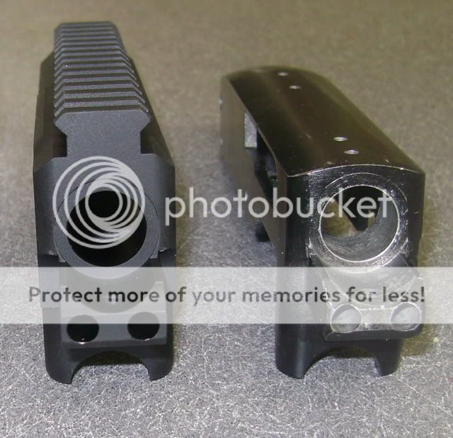

I still have a concern about how it would sit in a stock as the receiver is not contoured in the rear, like I said before Dr. Lector removed the pic with it sitting in the stock and it just didn't look like it sat right.

+1. Not contoured could lead to problems. Lets see pics.
I am not sure what kind of problems it can lead to. Care to explain?
The rear of the receiver is straight, not tapered, not slanted.
I am not sure how else it can have picatinny on the full length
if the receiver was not straight.
In addition, the top is thicker than OEM, with picatinny or not.
Therefore, its top rear is higher than the OEM Ruger receiver.
So are a big majority of the aftermarket receivers on US market.

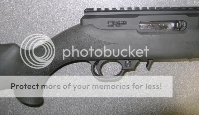

Yes, it does stick above the stock, like the center-fire semi auto Rugers,
like the M-14 or whathaveyou.
This above is a DAR-22 receiver that is fully-seated (not bedded)
in a regular Hogue stock.

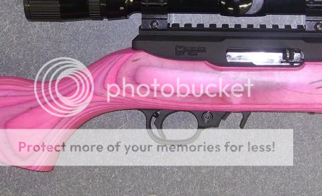

This one is emo-kid Clobbersauras' gun:

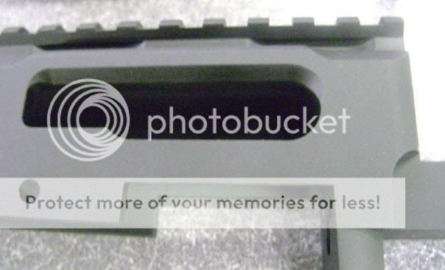

Detail of the ejection port that is flared in its upper half:
So, let me ask this again, what are the potential problems
of the non-contoured rear, other than not blending in with the OEM stock
or not matching your image of the 60's style?

Good call on the pink gun clobb maybe we can have guns as long as thier pink . but ill have to check with rcmp. id paint your type 97 pink or disquise it in a empty pepsi box better yet a tim hortons donut box ...thats the last place they look

My mistake. I was under the impressing that the back of the receiver was square instead of having rounded edges, which would be a problem fitting into any stock.
My mistake . They look great.
