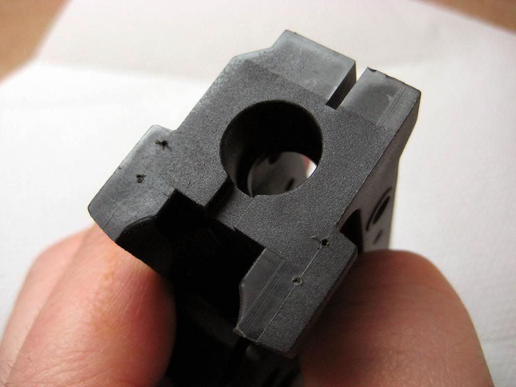

Here is where I will drill, first hole is 8mm from bottom (along flash/mold line) and the next hole is 4mm above it.
There it is...

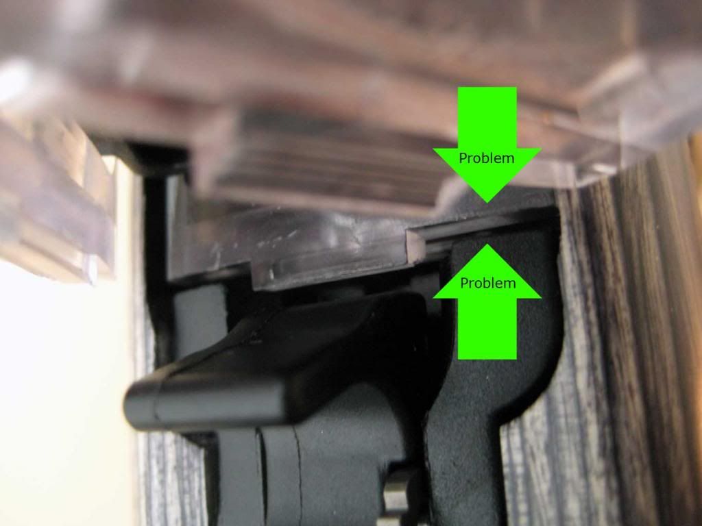

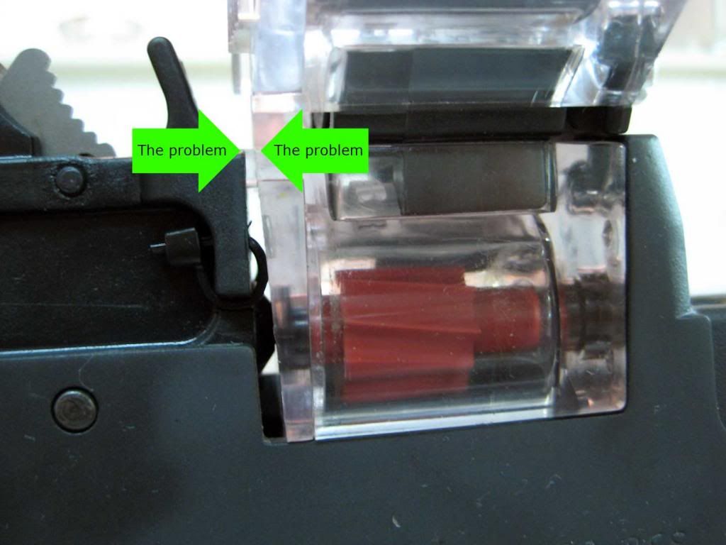

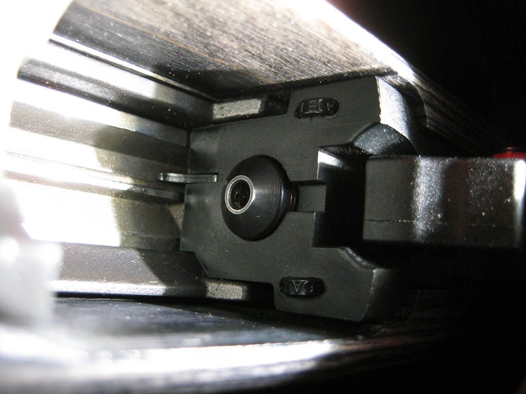

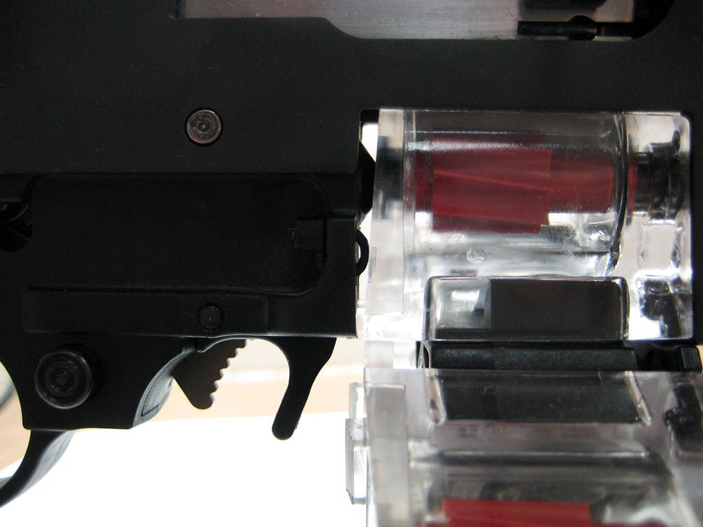

The problem: Too much gap between the mag and the trigger housing and weak OEM magazine latch plunger spring. While shooting, should the mag get bumped or move rearward under its own weight (within the mag well) the next round will Fail-To-Feed.

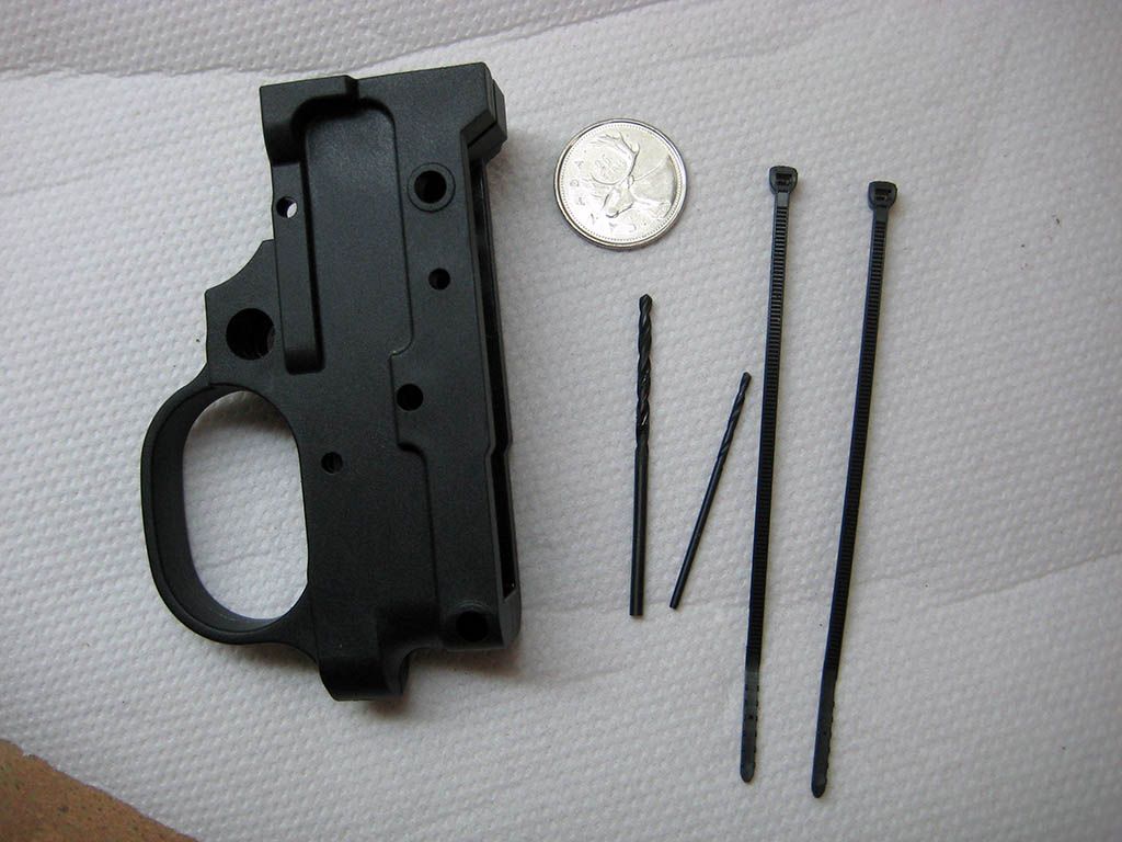

The solution had to:
-Provide tightest clearance possible from magazines to magazine (all manufacturers.)
-Still allow easy insertion and easy removal of magazine.
-Not wear or damage magazines.
-Permanent, simple, robust and require no servicing (basically be worry free and reliable).
Ladies and Gentlemen, I give you the 'Zip Tie' mod (UV Black Minuature ties 4"/102mm):
Again, the problem space with the fix as viewed from the side:

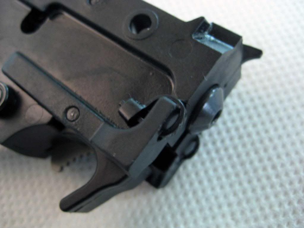

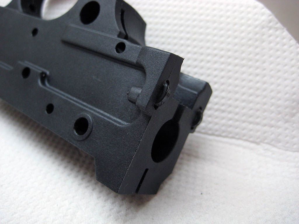

Two holes drilled to accept the small zip-ties.
I tried to get fancy and make little recesses for the zip tie so that they are perfectly vertical, but not required, I wouldn't do that again... just drill and go.

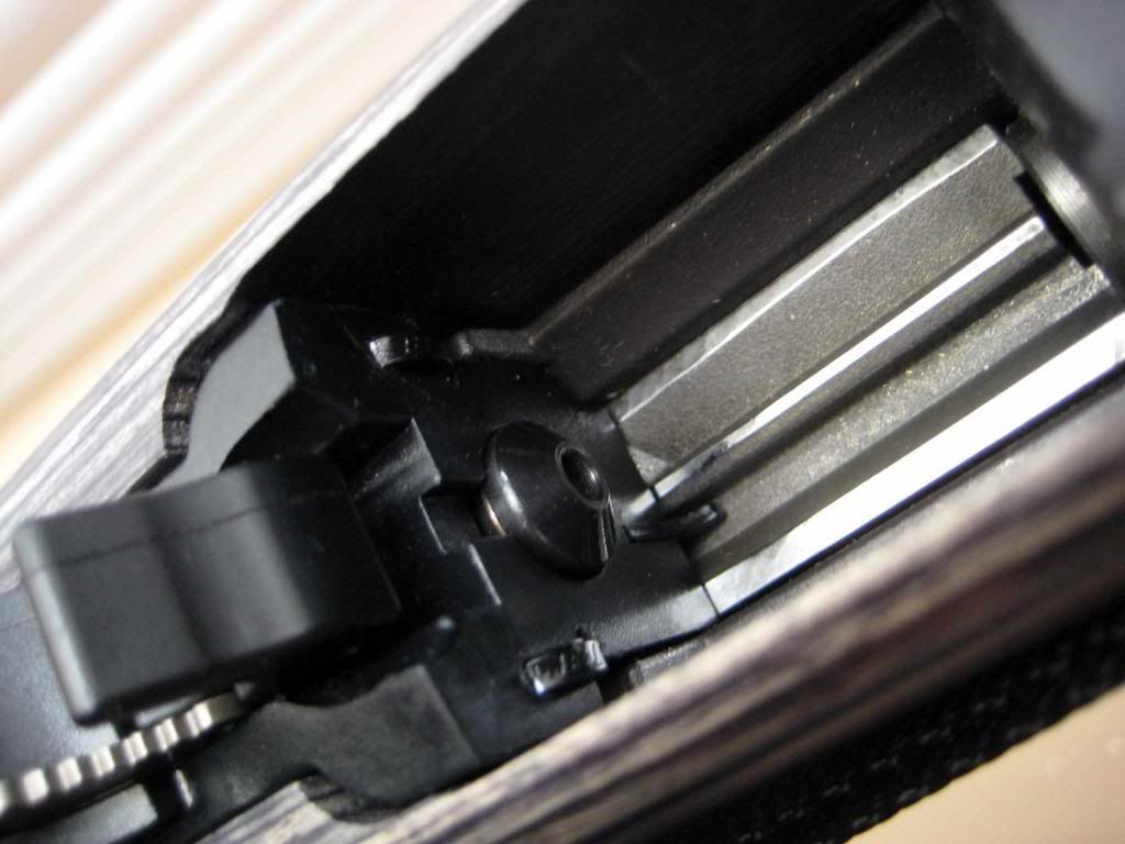

Installed.
It's not pretty, but it works like a hot damn.
I am very pleased with the fix. Magazine lockup is now incredibly tight; I can actually hold the rifle by the mag, pull on it while shooting and the next round will still chamber. I would never have thought possible from a 10/22.
There it is...
