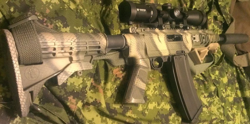

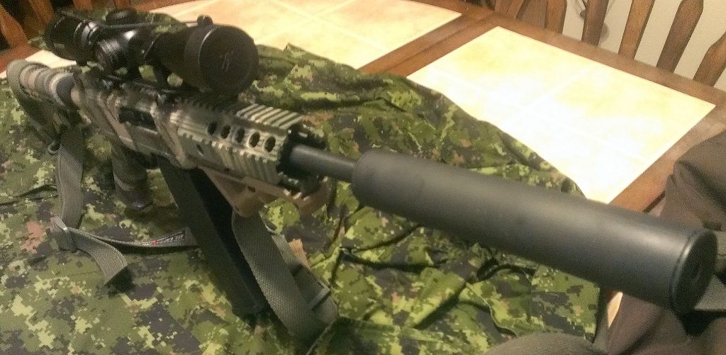

Here's mine.. giving it a make over soon if I can get my hands on a Troy Chassis.
LOL.. Good one
LOL yup just posted it in another thread as a few of you know.. I've had the thing for over four years. Bought it off evilbay and don't have the records anymore from whom I purchased it from but there are a few on there currently that resemble it.. Just search for cheek pad in sporting goods and there is a ton. I prefer the velcro attachment as opposed to the ones that are tied. Just quicker and cleaner look. I've used this on the 10/22, a Marine magnum 870 and various H&R rifles.

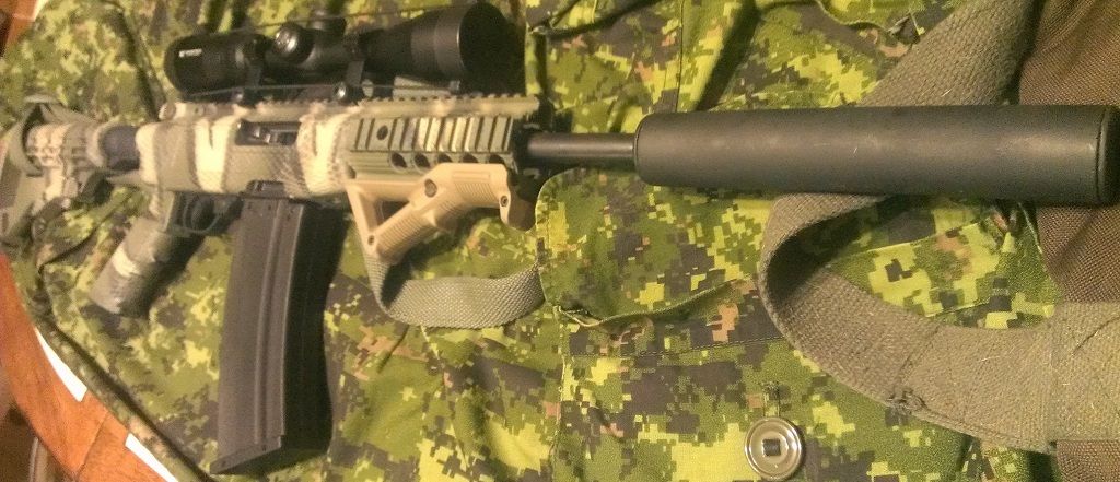

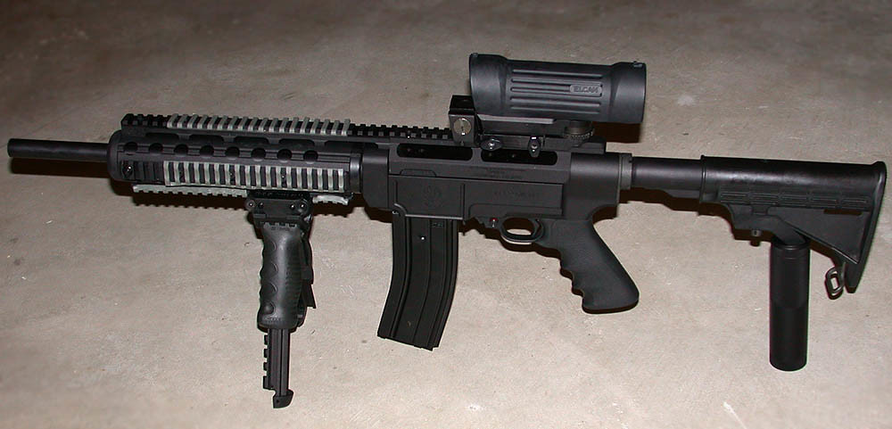

It's all show... I know, I know. The Magpul AFG2 is PTS and the stock is Chinese knock-off. The PTS AFG is definitely of high enough quality, the stock is decent. The build quality feels strong but there's a little wobble on the buffer tube. The stock Ruger stock had a little wobble, this is just a little more wobble than that. But holds position without a doubt and doesn't really feel too cheap by any means.

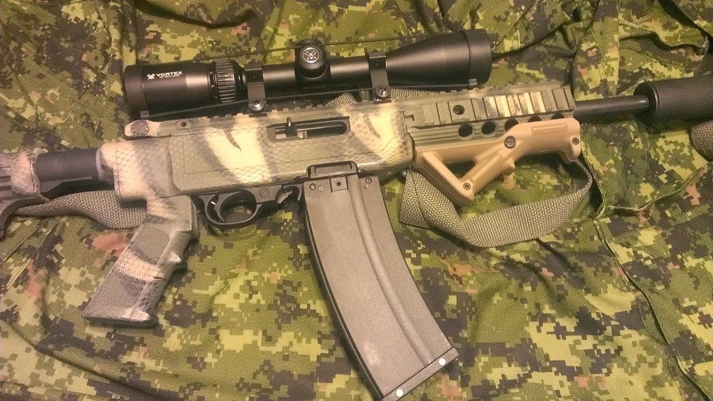

Magpul CTR Mil-Spec Stock for my Ruger SR-22
The CTR locks down rock solid
surprise Scope should be here in about 2 weeks.. just wait ;D

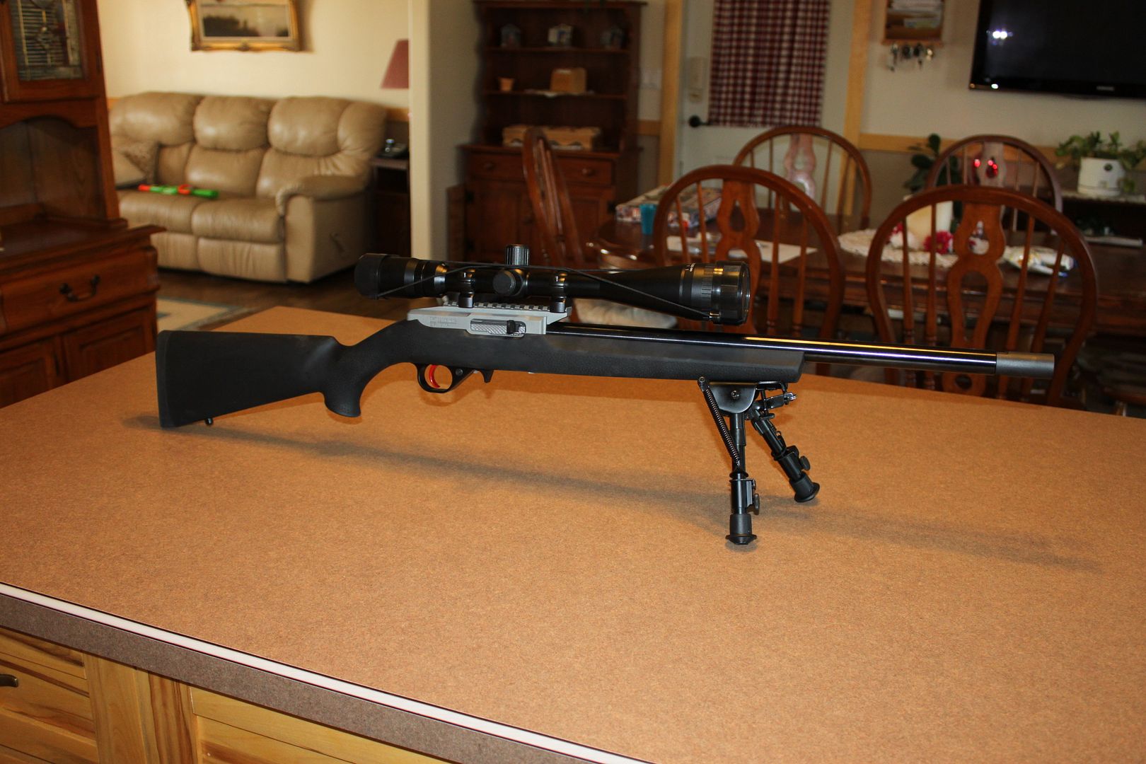

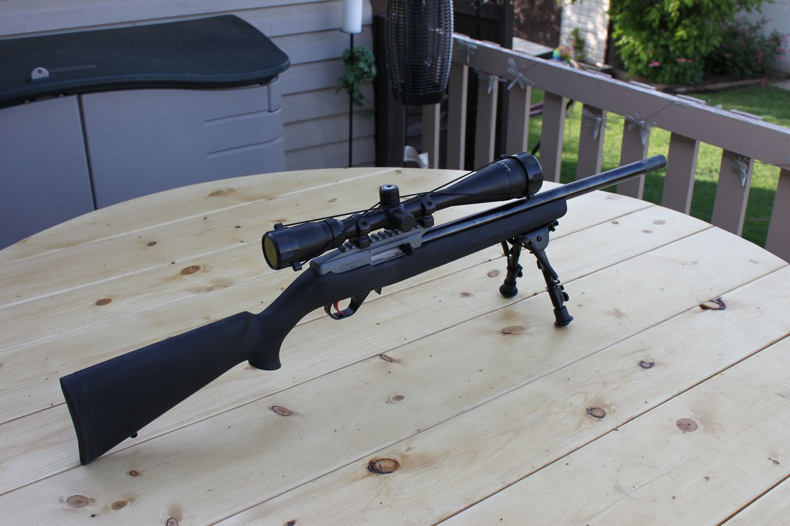

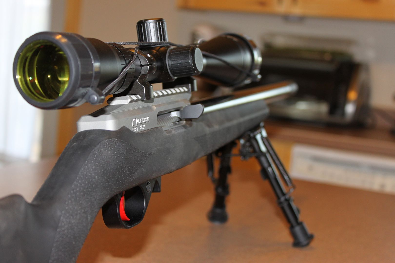

I decided a while ago to build an accurate 10/22 a while ago and finally got all my parts and assembled it last night. Went to the range after work tonight just to check function, it works great. :D Build consists of a Dlask receiver, Kidd 20" match bull barrel, Kidd 2 stage trigger, Kidd bolt, Kiddcharging handle, Kidd guide rod, spring and buffer. Put it into a Hogue over molded stock for now. Mounted a Sightron SII Big Sky 36X42 mm target scope set in Burris Zee rings. BTW it does use a Ruger 10 round magazine :p Here are the obligatory pics.

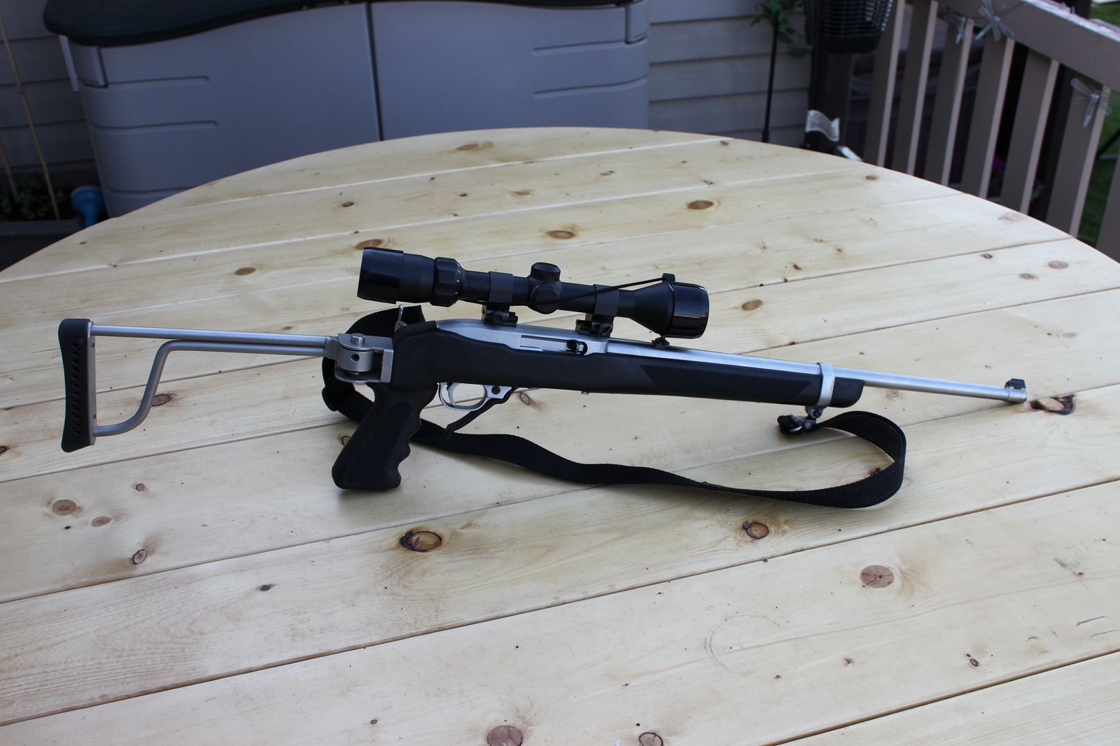

here are the 4 i have.
3 are finished.

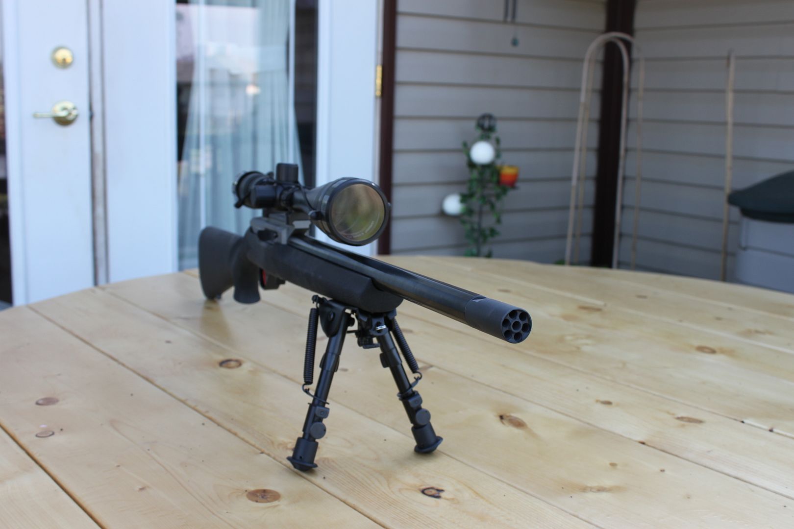

the big black beast just below, im done working on that one (i copied the post i had up on the main rimfire page about the build)
this is the 2nd or 3rd revamp of this gun this winter/spring and im finaly happy with it and im gonna go ahead and call this one DONE!
i had it out at the range today and tested it out in the wind and rain and it purrrrrrrred like a kitten!
hopefully when i get off work next week i can have a couple days without wind to see how far i can reach out with it with accuracy.

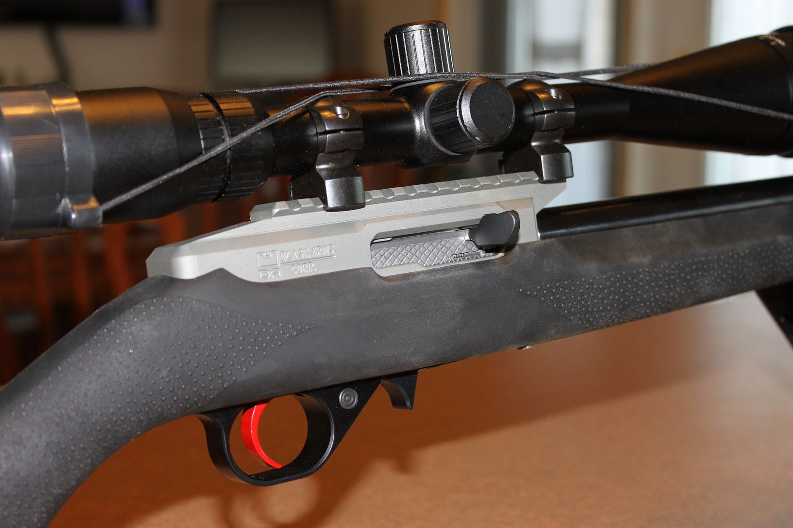

at any rate, submitted for your approval is my all custom made Ruger 10/22.
Black Hogue Stock.
DAR 22 STERLING RECEIVER With INTEGRAL PICATINNY RAIL.
DLask 18.5" heavy bull barrel.
DLask Compensator.
DLask charging handle (scull pic on the front)
Kid 2 stage trigger set to 1.2lbs (i think, ill test it here in a minute to make sure)
Kid silver scalloped bolt.
Optics is just some cheap glass i picked up.
and a bipod on the front, thinks it champion.
i hand sanded the inside of the receiver with 600, 1500, 2000 wet dry paper then polished it with mothers aluminum polish.
same with the bolt, gave it a mirror shine.

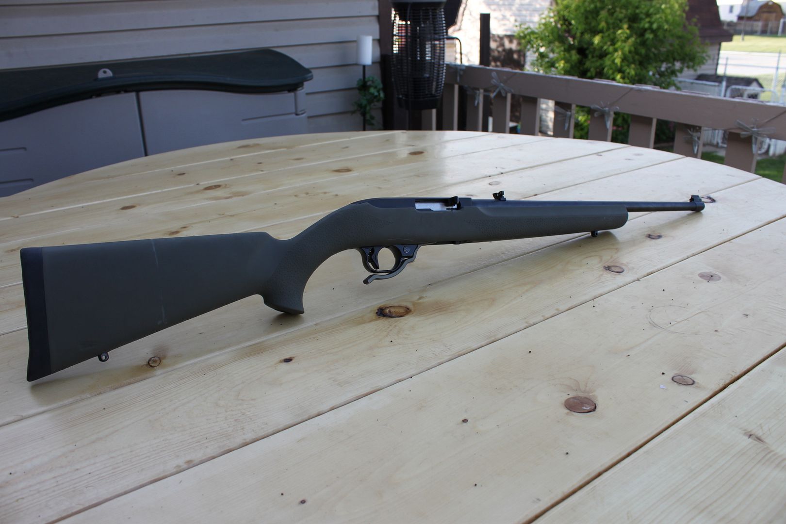

then my 2nd one is my original Ruger 10/22 from 1988.
ive switched out the stock with a Hogue OD Green, a tactical solutions long mag release, a VQ bolt release and all new VQ internals (strut, seer, hammer springs, trigger) all came out of my big build above.
the barrel and receiver are both brand new, i got them off the last build im doing right now (blue gun at the bottom).
the only thing i have left on this one that i want to do it replace the factory iron sites with fiber optic ones.
they are in the mail as we speak.
the third one here is one i picked up new back in 1991.
i was down in the states a month later and picked up the Butler Creek folding stock for it.
love the gun, its probably have over 50k rounds through it.
