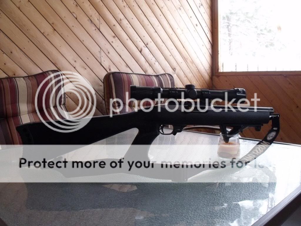

Which stock is this?

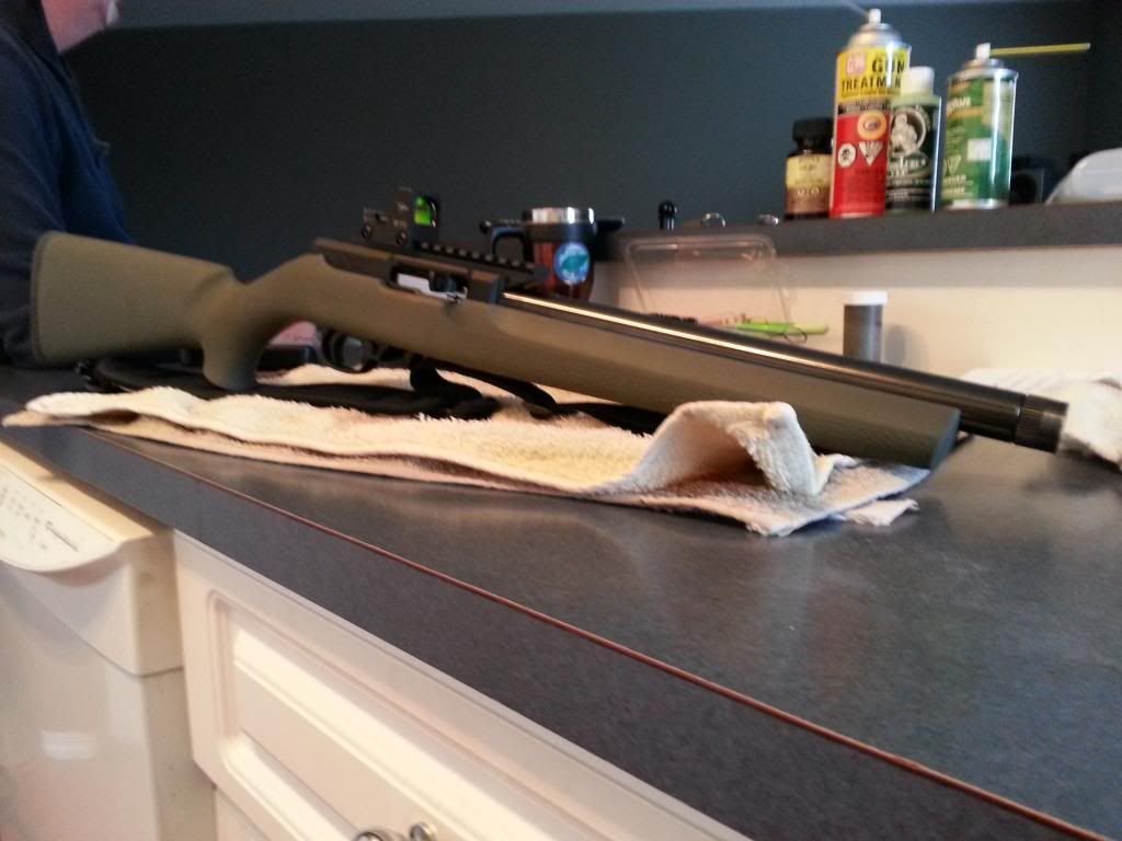

just finished 2 builds tonight.
the first is one ive been working on all winter.
(if ya look back in the posts you will see version 1 of it)
it started as a 28 year old ruger 10/22 that i got as a kid.
stripped it down to nothing and started from scratch.
had a couple problems and had to ditch the original barrel i had on it and then upgraded some more.
NOW, finally done, and this is what im left with.
FrankenRuger
ok, build list.
Dlask reciever (with built in high rise rail for BIG scope)
Dlask 18 1/2" heavy bull barrel (threaded)
Dlask compensator.
Hogue OD Green Overmolded Stock.
VQ Bolt, pin, ejector and springs.
Kidd Trigger group assembly (not in the pic, had it out today at for some testing)
one in the pic is stock ruger trigger housing with all VQ parts inside.
VQ buffer bar and Bolt Release.
VQ set screw trigger.
Tactical Solutions extended mag release (in OD green)
Dlask Charging Handle (with a scull on it!)
the gun is HEAVY!
that barrel is a brute!
its gonna be a bench shooter for sure!

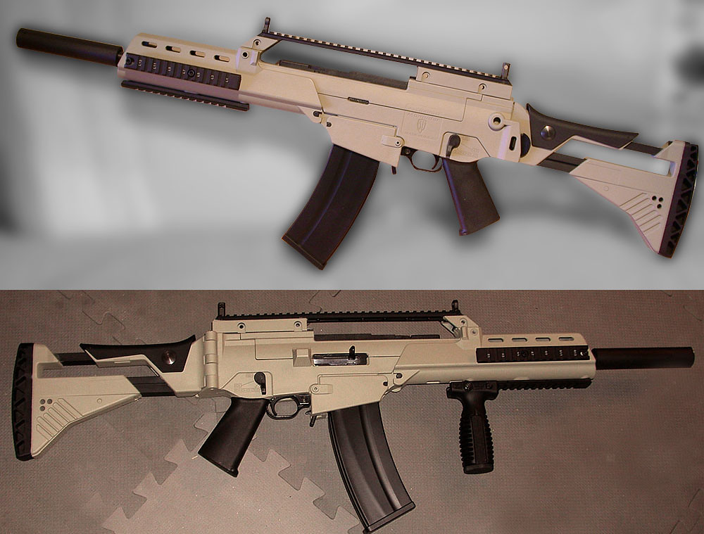

Here's a WIP photo of my Nomad. Just painted it yesterday with Krylon Flat Tan. The paint is pretty forgiving - I thought for sure I was going to have drips, but it leveled off and dried with a nice even matte sheen. Not sure how well it will adhere to the plastic stock, time will tell.
I didn't fully reassemble as I have a shorter barrel on the way (going to have to pin the IDZ stock). Looking at some shorter fore grips too, some kind of red-dot sight, a few other bits.
Lots of inspiring G36C threads on here, so thanks to those guys for getting me interested in this project. I'll post pics when its all back together.
