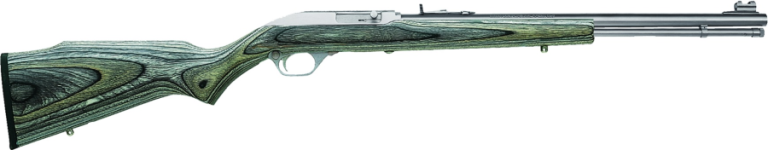

Marlin made their 60 with tubular mag but they also built one with removable mags. People seem to hang on to both of those, as they seem to be great rifles.
Mendoza is making a bit of a copy presently, their 6000; all tubular mags though. :( https://www.mendozafa.com/en-us/categories/rifles
