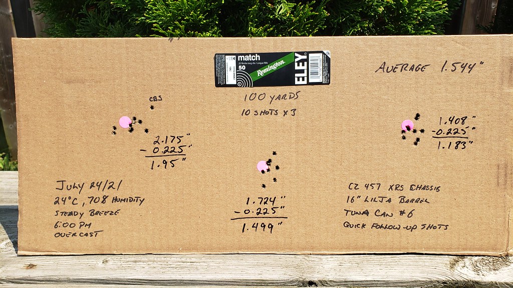

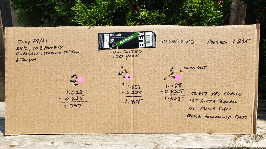

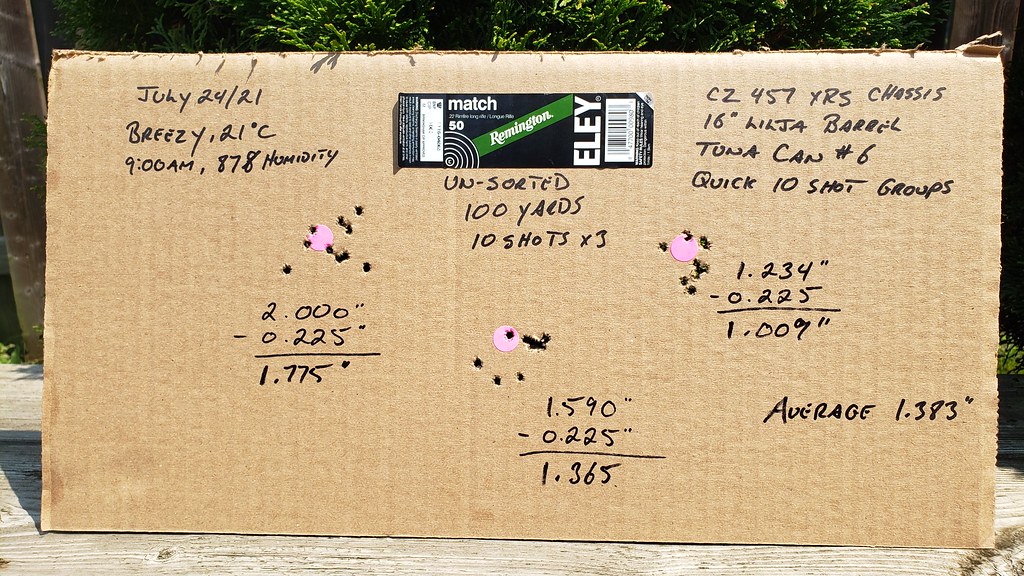

View attachment 510542View attachment 510543View attachment 510544View attachment 510546View attachment 510546
