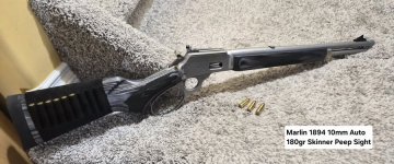

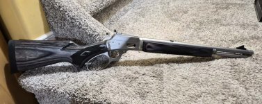

I know quite a few jumped on these when they came in earlier this year. I wonder if anyone has feedback after a few hundred rounds? How well do they feed? How sensitive are they to bullet shape and OAL?
Love mine.. shoots 150gr all the way up to 200 xtp. Load just fine.
Put my target scope on for load development..
Pic are at 100Y
150 nosler h.p. and CFE pistol. Standard 1.260 coal . 1625 fps.. 9.5 was getting warm. Close to max.
9.2 and 9.3 where stable e.s. and s.d.
300cci and new Winchester brass.
Shoot the pet loads for my other 10mm carbine well.. overall
Sweet like lever gun
