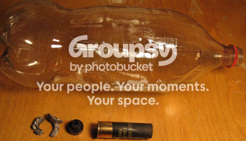

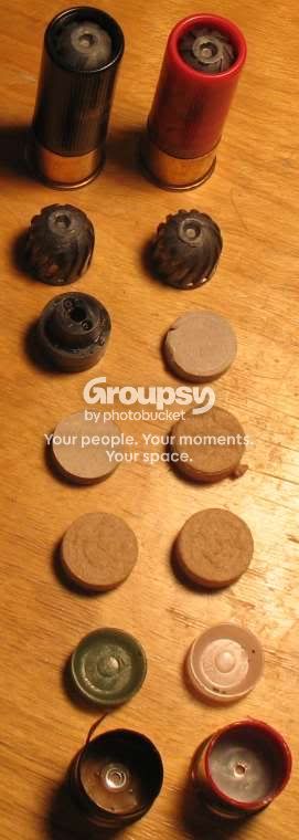

At the range in my smoothbore they shot just as well as my old faithful Power Points, but at twice the cost I thought I'd see if the slug is actually heavier as the chap claimed. The Rackmaster is in black, the Power Point red:
The black plastic is the "innovative WinGlide rear projectile stabilizer".

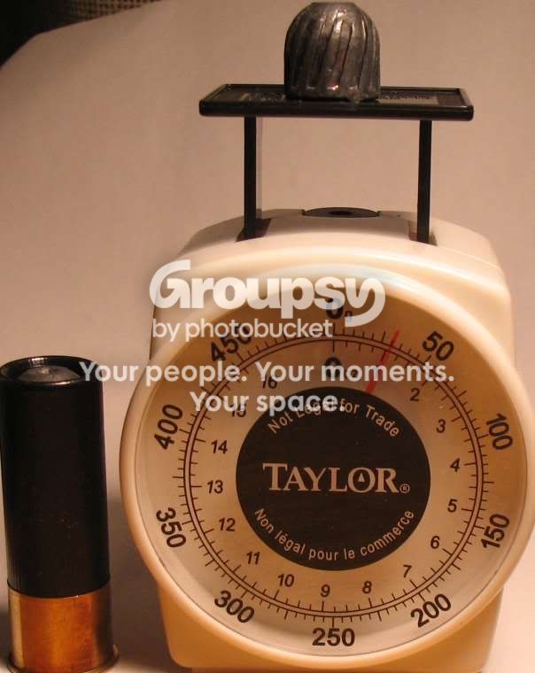

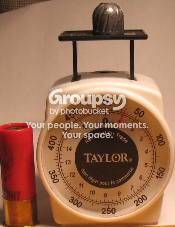

Ok, time to weigh them. Are those footsteps ? Gotta hurry !
Booo ! They're the same weight, you're just losing velocity over the Power Points but gaining some potential accuracy from the stabilizer.
Because this is a 2 cent test, after I slipped the scale back in the kitchen and stopped hyperventilating I gave Winchester Ammunition a call.
A nice fellow named Paul agreed that it's the same one ounce slug in both shells, but they add the plastic stabilizer to the weight of the Rackmaster and call it 1 1/8oz. He said they're attached, but in my case the stabilizer fell out just from gravity. I thanked him, and he agreed if the accuracy is similar for my smoothbore I might as well save the money and still keep buying the cheaper and slightly faster Power Points for black bear.
