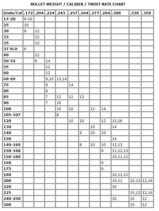

So my question is, will 165 grain bullets shoot ok in a 1 in 10 rifled barrel.
Would 150 grain be better or worse?
I have absolutely no idea how the twist rate affects bullet stability.
Any thoughts?
Generally the longer, heavier bullets require a faster twist rate to stabilize. My WInchester Model 70 in 6.5x55 has a 1 in 7.87" twist rate as the 6.5x55 was originally designed for long 160 gr bullets. The 1 in 7.87" twist also gives good accuracy with 100, 120 and 140 gr bullets too.
My Winchester Model 94 .30-30 has a 1 in 12" twist rate and is accurate with 100, 130, 150 and 170 gr bullets.
There's actually a formula for determining best twist rate, based on bullet geometry and weight as well as muzzle velocity. I built an excel sheet that calculates true BC, Miller Stability, and best twist rate. PM me if you'd like me to email it to you.
Cheers!
A 165 is the ideal hunting bullet weight for the .308(and .30-06). Kill any game you care to hunt. No arithmetic is required.
The equation may be used as follows, where;
MV = Muzzle Velocity
D = Bullet diameter in inches
L = Bullet length in inches
Twist rate = 3.5((MV^0.5)*(D^2))/L
eg:
Twist Rate = 3.5((2560^0.5)*(0.308^2))/L
= 3.5((50.59644)*(0.094864))/L
= 3.5(4.79978)/L
= 16.799233/1.350
= 12.44 (round this number down according to rules)
= 12:1 twist rate
Hope this helps shed some light on the math side of things!
