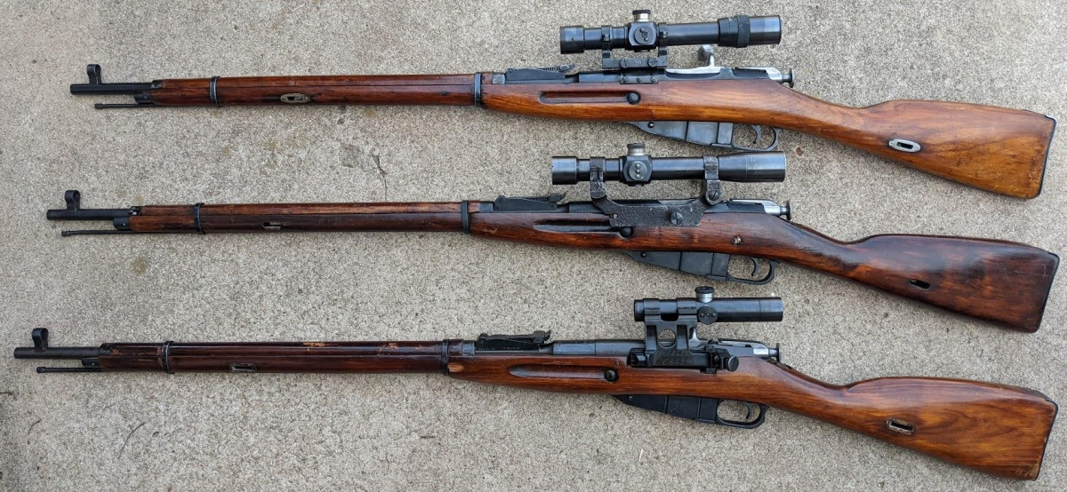

Here are three examples of the evolution of the mass produced Soviet 91/30 sniper rifle.

I resnipered a '42 Izhevsk PEM that I use as a shooter. Found and original base, mount, and scope for that one. I'll take some pictures and post that one in a bit.
