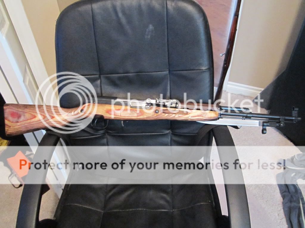

1954 Russian SKS -- laminate stock refinished in tung oil
Decided to just strip it and rung oil to an "au natural" finish. One coat down, 4 to go lol. Argh, why does it have to take 24 hours between coats??! Lol

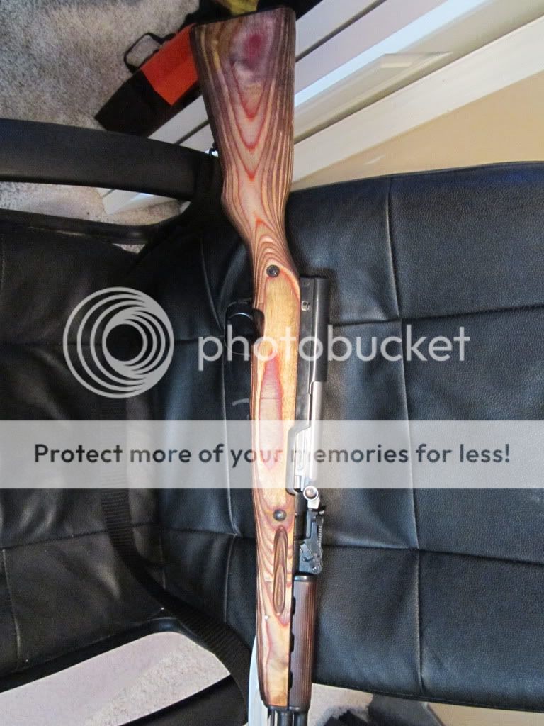

Guys, its better to be patient. I've learned that from experience. I would simply wipe on one thin layer of tung oil, let sit for 15 minutes, wipe off any excess and then walk away from the SKS for 1 day -- as hard as it is to walk away and not tinker with it, just do it. On day two, give it a light "wipe down" with 0000 steel wool, use a clean cotton cloth to wipe off any steel wool fibres, then add another thin layer of tung oil, let sit for 15 minutes, wipe any excess and then walk away from the SKS for 1 day. Repeat this easy routine for 3 to 5 days, until the desired effect is reached. You don't need much tung oil, and in fact, the heavier you apply it, the less likely it will soak in and dry.
I find that after 4 or 5 applications you get a nice hard matte sheen finish. Perfect for a milsurp of this vintage.
After your last application of tung oil DO NOT give it another "wipe down" with 0000 steel wool, simply let it cure. I usually don't touch, or TRY not to touch the wood for about 5-7 days to ensure that the tung finish has had plenty of time to harden and cure.

Tung oil will give it a nice honey shade and will slightly darken over time after fully curing, as noted in my second batch of photos ('52 SKS). If the SKS already has a stained finish (usually a nice Russian red tint), it will come out darker (brownish and/or reddish) after tung applications. I personally do not like how laminate birch responds to stains as its prone to a blotchy or streaky appearance, and as such, I simply go with whatever colour the wood started out with. From what I understand, birch in general does not stain well and is best left in its natural state (blonde or near-white) or painted. BTW, most/all Russian laminate birch stocks have red coloured glue layers.

Is it darker than my '54 on page one as well?
I'd like to see it.
I'd like to see it.

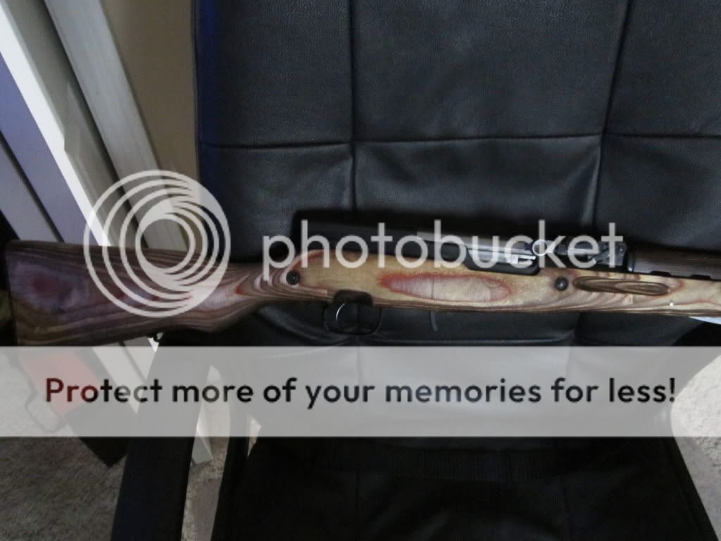

I just rubbed it with 0000 wool before last coat(#6), wiped down with a clean cotton rag. Then gave it a nice coat of tung oil and did not wipe it off after the 20 min, then let it sit for over 30 hrs. Leave it and walk away. I did not use wax.
It came to a nice hard coat.....buffed it with a cotton rag and here it is........................ tried it out on my chinese....I will more than likely install this on my 1950 Tula.
