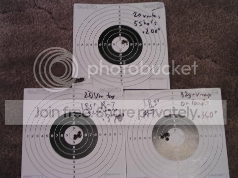

I bought a Cooper in 20Vartarg earlier this year from Prophet River. I bought the Redding Match Neck Bushing Die set, and bushings, from Sinclair and I found some Nosler 221 fireball brass, and I mounted a 3-15x42 Zeiss HD5 scope. While fireforming with a cataract in my shooting eye, I was easily able to shoot five shots sub 1/2moa using the 32gr v-max, ahead of R-7. I shot groups as small as .200" at 100 yards, but the average was in the .350" to .400" range. I just recently had my cataract dealt with, and I now have a good supply of fireformed brass, and I hope to see the rifles true potential in the next week or two. I also recently purchased a Cooper in 20 Tactical, so I will soon be able to do a side by side comparison of the two cartridges.

Some fireforming groups from my Cooper. Two are pretty average, the top one was the best group to date while fireforming.
