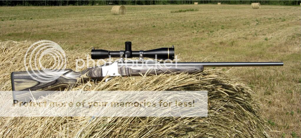

just got my first 300 Mag, a wedding gift from my wife

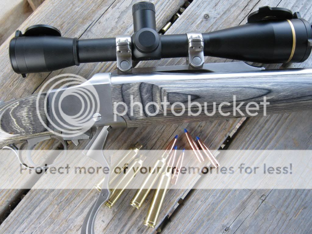

Elk being on the menu this fall, and seeing the good effects of the 200gr TSX in my 8mm Mag last fall on a nice 6 pointer, I decided to start there with the 300
Picked the new tipped version because it's cooler than the hollowpoint, and hit the range this evening

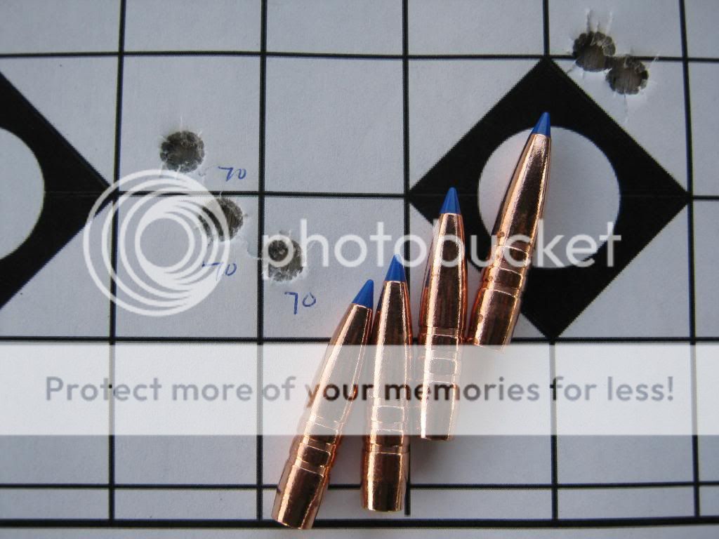

Grabbed a favorite powder, H4831sc and started at 66 grains, worked up to 70 grains and hit 2850 fps over the chrony which is plenty fast so I loaded a few more and tried some groups at 100 meters
1" 3 shot on the left, made scope adjustment and shot the pair on the right into about 1/4"
Shot a 3" 3 shot @ 200 meters, I think I will load up some more and try them at further distances. With the high BC of .546, it should do fairly well I think. Perfect bullet weight in the 300 Mag's IMO!

Recoil isnt bad, 9.5 lbs scoped and its noticeably tamer off the bench than my 8.5 lb 8mm Mag
