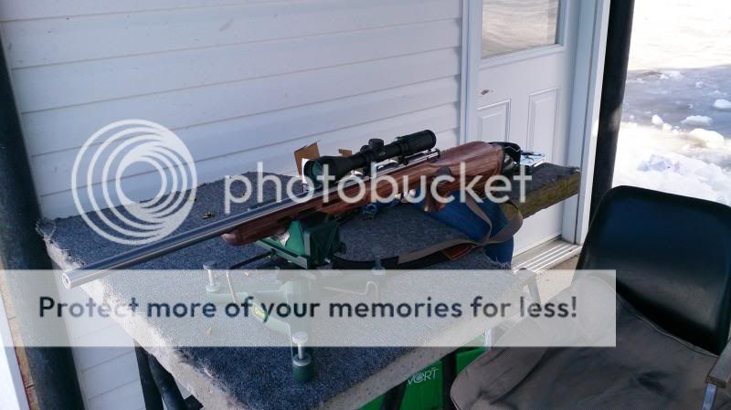

200 Yard Savage BTVS 22lr, CCI Stingers first attempt
What's the scope?
Weaver 3-9x30 that came off a savage 308 16 ITH.

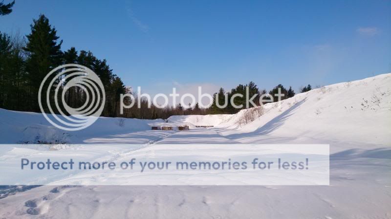

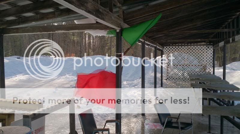

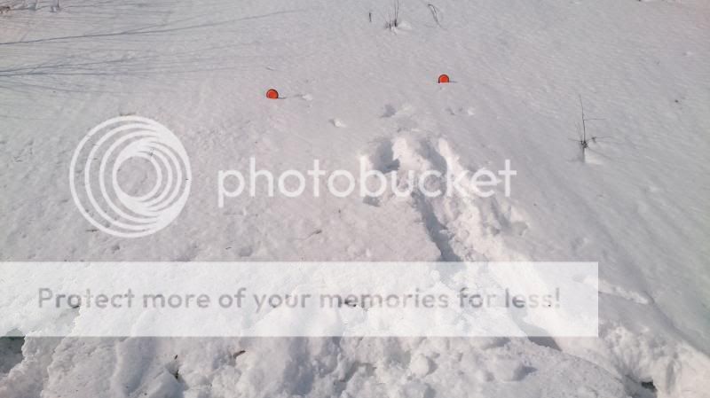

Well I made it back out....-4 and 15-19KM winds...look at the flag...pretty well horizontal....

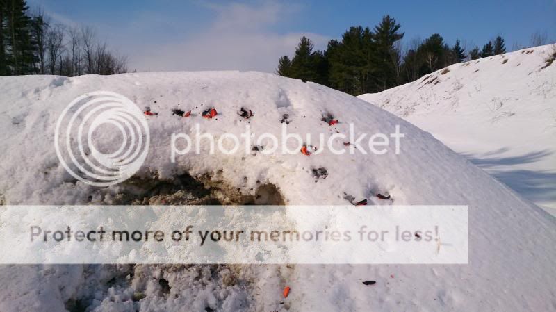

The range, about 10 clays ont he 100 berm and 2 at the 200.
The gun.
I used Winchester M22 40 grain bullets this time. Sighted them in at 100, had to raise the POI 4". The wind appeared to be pushing them to the right about 3-4" depending on the gust and then not at all between gusts...
I could hit the clays every 3 out of 5 shots and it took about 5-7 to completely break them up.

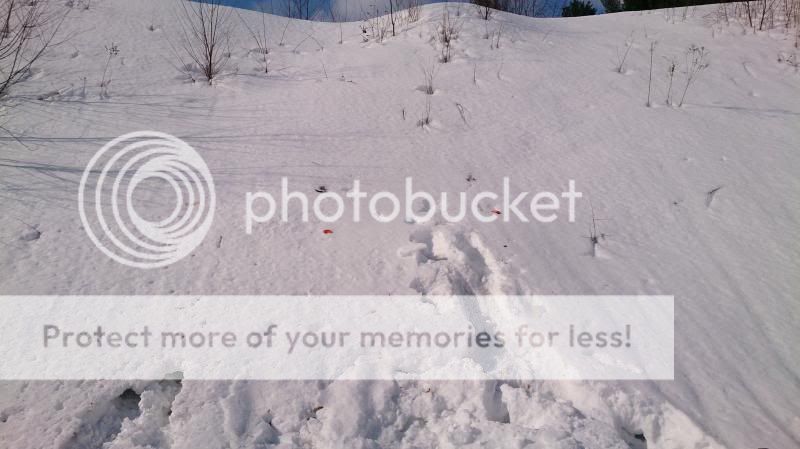

The 200 yard clays...not even touched for the first hour...
About an hour and 25 bullets later, I can see where they are hitting and finally get them. About 1 hit for every 7 shots. Got them both 2-3 times before they rolled down.
A 10 (yes 10) yard group with the winchesters. I'd like to say I pulled one of the 5....(at least give me that)
So I will stick with the Winchesters and demolish the 240 clays I have left in the upcoming days :)
