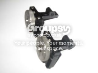

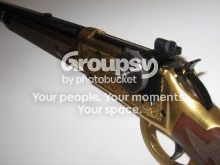

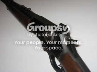

What the purpose of the group was to test a new sight I invented. For years I tried available receiver & tang sights so that I could use my low velocity open sight guns for hunting, but always ended up leaving these in the gun cabinet when the hunting season began as I could only trust these to about 125 yds aiming on & adjusting them took too much time that I might lose my opportunity to shoot.
So I came up with a receiver sight (tang sights always seem in the way on a levergun) that compensates for bullet drop. It uses an interchangeable cam that is profiled to match the trajectory of my gun & load (with click settings spaced @ 5yd intervals and profile calculated to 1 yd intervals) which is interchangeable, so I could use a different load if desired by swapping cams.
The target represents my first test of this. The second test came in deer season:
When I saw a deer sneaking thru the bush about to come into a hole in the bush. I didn't have time to range the distance but as I had been using the rangefinder all morning in the area I estimated 150 yds, adjusted to that distance & took the shot. Then I took the rangefinder out to check the distance - 152 yds. I felt confident of the shot and the result was a heart hit & dead deer found within 50 yds that I would have missed or wounded if I had "aimed on" with any of the previous store bought sights I had used (drop was 11" @ 152 yds)
