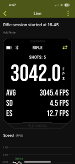

I wasn't getting pressure at 29.7 gr so I went to 30.0 gr and tried a 5 shot group, at .02" jump. I don't recall what it was exactly, but I was searching for better. I typically do a .04" jump, then 'touching' and see what the trend is. In this case I went for .04", and loaded another 5. This gave me 1.31", with four of them in .74", Good enough!!
Speed was excellent, pressure wasn't an issue at all and the ES/SD was spectacular.
