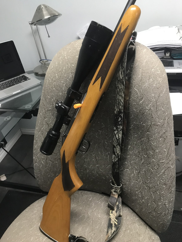

Now you need a extended charging handle, I know a guy ;) I love my 64Bs, something about a .22 with all metal parts, not a piece of plastic on them. Also like that they were built here in Canada, although that doesn’t mean much to most nowadays. Yes, the newer mags with the red follower don’t work as well as the old ones with the white followers. I start all new shooters on a 64b to start, that way they appreciate a normal trigger weight on their next rifle lol. Happy tinkering.

Gota say I’ve never seen an iron sight setup like that, I like the folding stock too I need one for mine, next I’d get a file and bevel the mag well a little and extend the mag release, I’ve seen people do that with a pice of coat hanger and JB weld, then extended bolt handle and 20 round mags, that’s what I’d do anyway
I have a couple ideas of how to deal with the mag release. I have two 10 round mags, but there is a 20 in my future also. The backup sights fold flat when not in use. I got the Pro-Mag folding stock from Dr. Deals, it was the best price at $99.00. I like it, it is really solid!! The compartment in the pistol grip holds a 10 round mag too.
