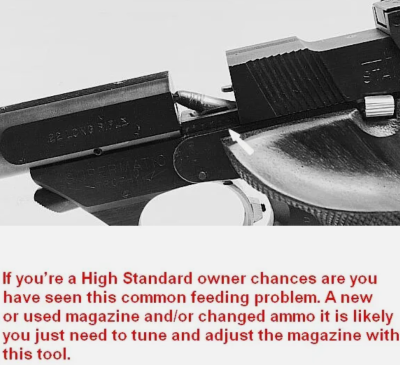

Gobels in London, but get the gun fixed or fix the mags; longs likely will run worse.I would consider fixing the pistol as it is made for the .22 LR round. It shouldn't really function well with a .22 Long.
.22 Long ammo is a dead horse as far as I am concerned... https://ammo.com/rimfire/22-long-ammo
<https ://arsenalforce.ca/ammunition/ammo/22-long> (But they aren't the solution for your problem.)Wife has a 22 High Standard Citation. With long rifle cartridges it tends to feed poorly after about 50 shots due to the length of the projectile. Anyone know where in Canada I can get 22 Longs? Appreciate the help.
They don't like high velocity ammo either; longs generally are higher velocity than LRI have a HS Supermatic as well, I don't think 22 longs are actually going to solve that problem. I would strip it down and clean it very well, then look to your mags. I use 22 LR in mine (unless I have the 22 short kit installed), and it is amazing how filthy it can get with some ammo. - dan

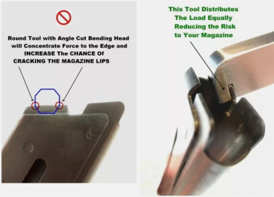

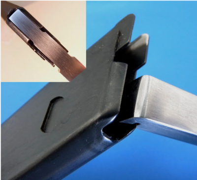

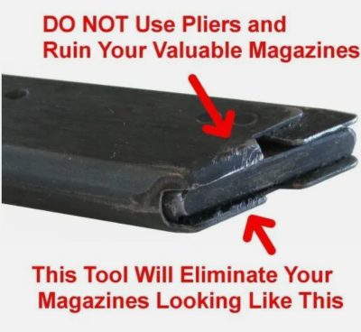

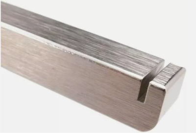

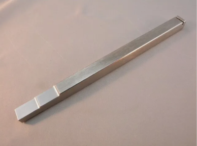

I kinda doubt there IS a 'special tool'. More like instructions to tweak the feed lips in or out, depending on how the cartridge sits when loaded, and how well it reliably feeds, so my bets are that it requires a pair of pliers, and possibly a small bench vise to squeeze the lips inwards evenly, as required. I worked in a Military Small Arms shop for a while, and we had hardened steel billets that went inside each of the usual magazines (FN, Lee Enfield, Browning High Power, Stirling SMG) that we usually dealt with, so that we could whack bends and dents out, as well as reshape the feed lips, using a nylon hammer.Wendell, any chance you have a pic of this tuning instructions?
wondered what special tool might be used
Does anyone this will work to mend Colt 22 ACE magazines? It should right?
It should, you're tweaking the lips regardless. - danDoes anyone this will work to mend Colt 22 ACE magazines? It should right?
