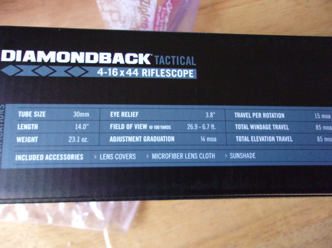

Next I needed a GOOD scope with enough calibration and BDC for the challenge.

the scope-

Some food for thought. A 34 gr. bullet x 2100 fps zeroed x 100 yds. In a 3MPH wind at 500 yds will have 27 feet ( 246 clicks) of trajectory and approx 4 feet of windage.

But I shot a sako 22 rf long range , I think you scope could be a bit bigger, I was running 15-20 power, It was a 8-30/50 6500 Elite, but over 20x It would wash out on me
