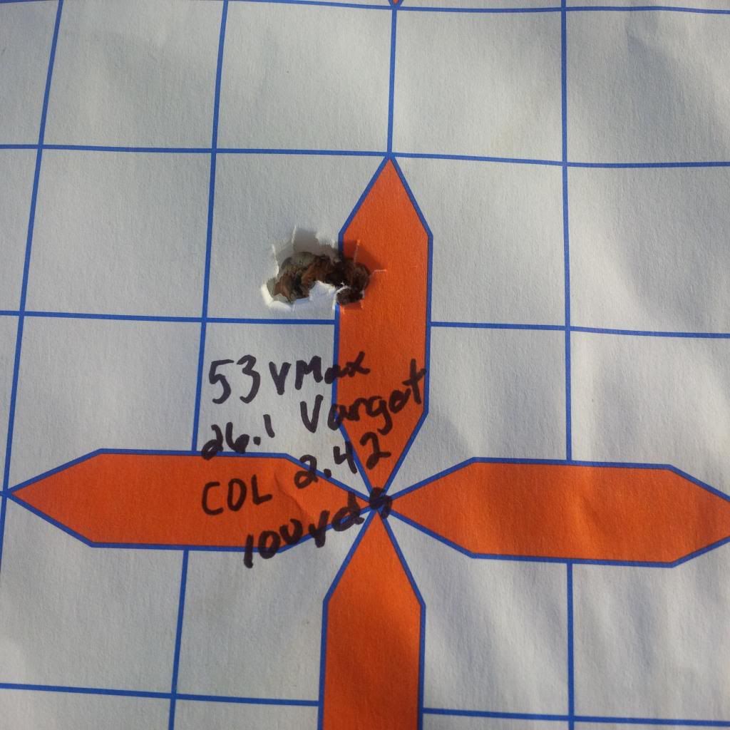

Well after a few trial an errors (more on that later) and with all the stars, moon and sun all aligned I got my best grouping to date. I just think theres was more luck then anything. :)
Im really happy with this grouping. I know that its only three rounds, but its a good start. And the wifey was there for a witness. :p The wife comes with me every weekend now because I got her hooked on shooting paper with the 17hmr. lol So today we went out at 6am this morning to get in some shooting before it got super hot out. This morning was perfect, no wind whats so ever. Just after shooting from the 100 we moved everything out to the 200 and it just happen that the wind started to gust. Just my luck. Well anyways my groups opened way up, so I quit. lol No we just moved into some cover so we could play the 17 some.

As for the trial and errors. What I was doing wrong, was I wasnt putting enough lube inside my case when I was sizing it. There wasnt that much resistance but I guess it was enough to stretch the neck/shoulder back out and that made my bolt kind of hard to close. Well thats in the past now (thanks ALOT Carl) and Im thinking of picking up a "Lyman Carbide Decap Rod". Its suppost to help. I guess we"ll see since its only 35 bucks to my door.

Nice shooting! That is one messed up grass rat! As for your neck sizing technique, which lube are you using? Very little lube is required in this step, and as per the Speer 14 manual (reloading step 5 I believe), dry neck brushing (in your case, with the small neck brush) is often enough to allow the case to pass over the expander ball with minimal resistance.
However, I usually dry brush the case necks AND apply this: DRY CASE NECK LUBE . All you do is dip a very small portion of your neck into the media and you're ready to size without any neck stretch. Cheap (like 4 bucks), clean and very effective, and you are not required to remove this media after sizing. Just my .02.
And good choice in load selection, it is hard to beat varget topped with the Vmax. Once you get to playing around a bit, try some Speer TNT in 50grain, I doubt you would be disappointed. Works great in most 1 in 12 twist or 1 in 9 .223 rifles, and performs with the surgical precision of a scalpel on paper. Performs more like a stick of trinitrotoluene on varmints :D Cheers!
