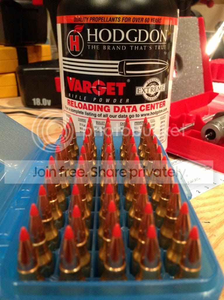

Just finished the batch. It took a long time because I trimmed, chamfered, pocket uniformed & flash hole deburred the brass. That takes a while even with power tools. .223 Rem is tough to load. I far prefer loading .270 or .308...
I will fire these tomorrow at the range.
These are:
Brass trimmed to 1.75"
CCI Bench Rest primer
55gr V-Max
25.5gr Varget
OAL 2.260"
