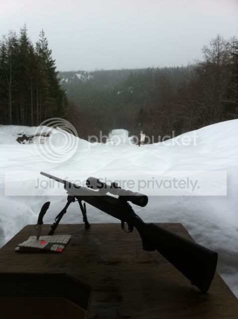

I shoot a couple different bullet weights from .223 with Varget powder. I use Federal GMM primers, and CCI primers. Just "Small rifle" primers. Nothing magnum. Very similar weight charges to you. I know that Varget is very "temperature tolerant" and this is important to me, since I tend to test in the cold, and compete in the hot. (Canada!) Varget has only ever shown minimal variations in pressure and velocity, such that I have never adjusted a load for climate extremes. Even the most compressed load of Varget I can cram into a 223 casing never goes overpressure in 30 plus degrees competing in the Southeast US or Ottawa in the summer, and I've never had problems in minus 10 and minus 20 winter testing and training with the same load back in Ontario...
My barrel is probably shorter than yours because I'm loading 223 for National Match AR15 (20 inches) so that (might) be a factor - but I doubt it. The gas system of the ARs function flawlessly in all temperatures with this same load. If Varget was burning any different in the cold, the gas gun would be the first to frig up. I also load a much bigger varget charge in my wife's 22-250. With her rifle, even in the cold, we've never seen unburned powder like you describe. And that 22-250 has almost 32 grains of varget burning to drive a bullet down 26 inches of barrel.
