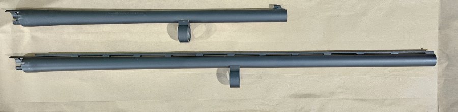

Here's a quick picture comparison I took of Remington 870 parts and Blue line pump parts. I'm no expert just an 870 enthusiast, any views and info is based off my personal experience with the Blue line pump i own, just saying this cause who knows there might be some variations between other Blue line pumps....
There's atleast two parts I've found that aren't fully interchangeable, that's the barrel because the the barrel lug that goes over the mag tube when installing the barrel is further forward than the standard 870 barrel lug.
So if one wanted to use actual 870 barrels on a blue line receiver you would have to create some kind of adapter tube to fit over the the mag tube in order to lock it down with the mag cap. And on the other hand if someone tried to use a blue line barrel on a standard 870 receiver, it would not work. The lug is to far forward, it goes passed the 4 rd mag tube.
Top is an 18.5" Remington barrel and bottom is a blue line 28" barrel. Different lug location
