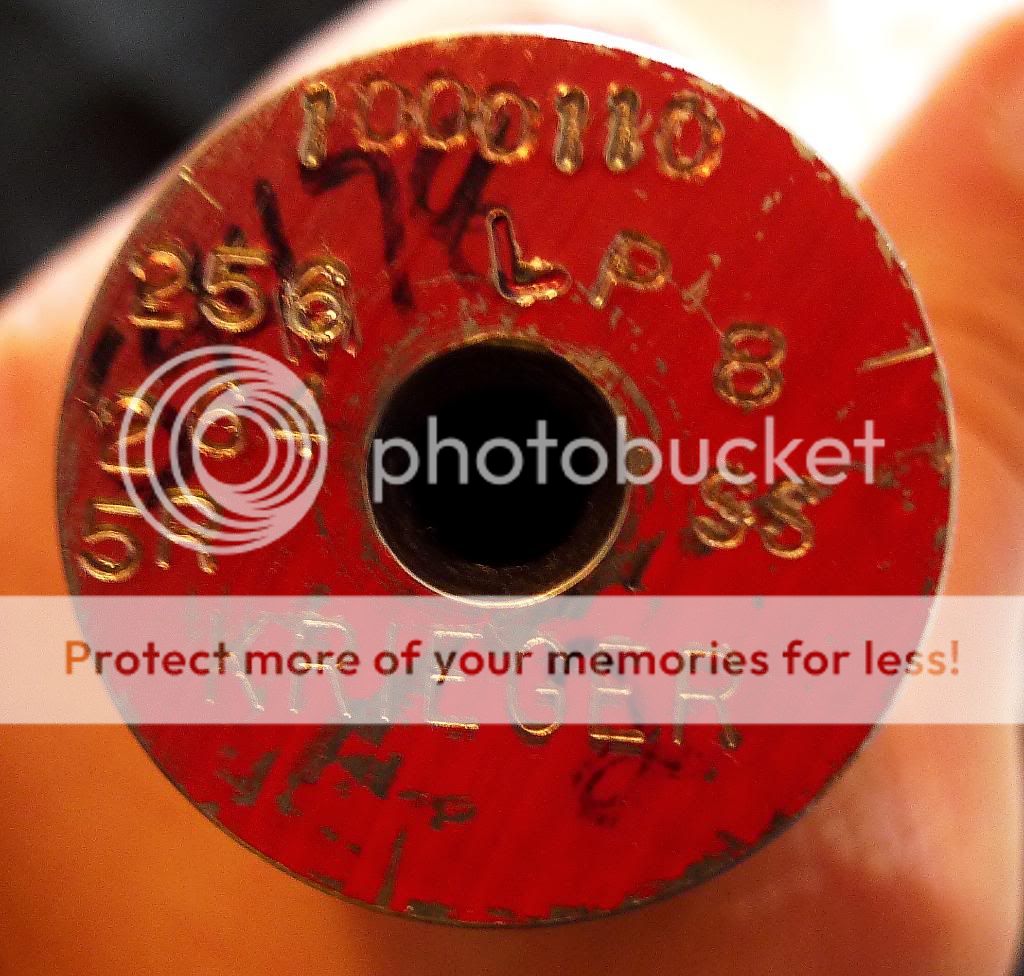

Actually, there are only 4 of you. One owner bought multiple barrels. Nobody has anything built yet, so the title of the first Canadian Krieger 5R rifle is up for grabs!
I think that I possibly had the first rifle, in Canada, with a Kreiger 5R barrel in my 6.5 EXTREME. I posted this on AmmoGuide 07/25/10 after preliminary tests were done.
