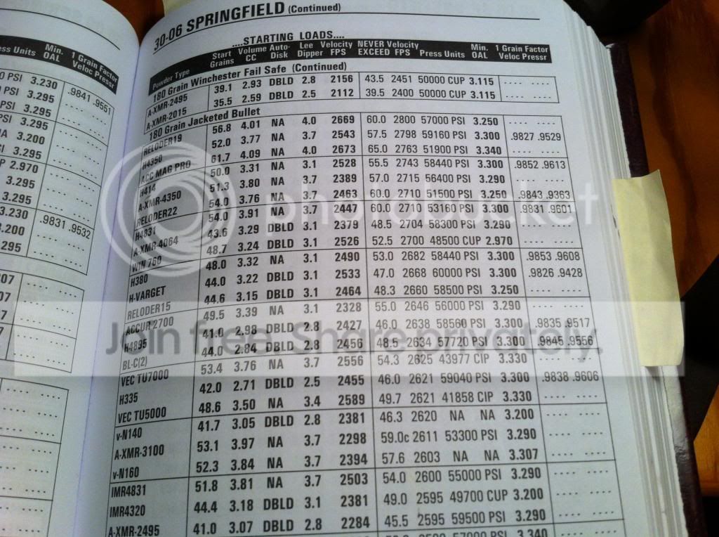

I was shooting my deer rifle today and it seems to like IMR4831 and I like it because the recoil is low. I was shooting at 25, 50, and 100 yards. 100 yards I can get less than 2” groups if I don’t shoot too fast and heat up the barrel. At 25 and 50 yards it’s under an inch so the thick bush I shoot it works well. For my fire arm 53.0 grains of IMR4831 works the best. I have attached a picture from Lee’s reloading manual that suggests 51.8 to 54.0 grains of IMR4831. I use Core-Lokt from Remington projectiles as they were premium at one time and I don’t shoot that far. Also the overall length I use is a lot longer than they suggest and is matched to my firearm. Also the overall length I use is a lot longer than they suggest and is matched to my firearm.
Hornady has me starting at 48.4 grains
This on the other hand is ridiculously low!!

I have the Lee manual too and I find their max loads are less than what the online data states. I am currently using IMR4895 and W780 supreme pushing 180 Nosler Partition. The 780 seems to have less kick and better power today. 2" high at 100yds with the 780. 1" high with the 4895. Same primers, same 3.320 coal.
