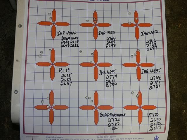

Tested some 165gr Accubonds different powders Rem 700 22" barrel
Some results of testing different powders in 30.06 most loads under max load
