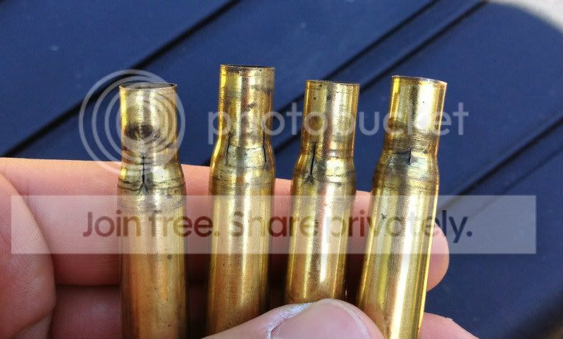

Just got back from the range with a new-to-me Marlin 336.
I fired 30 rounds, and four of them are pictured below.
These are the only ones that split. I have never had this happen before.
They all grouped as normally as all the others.
What are some possible causes for this happening?
Anyone else have this happen?
(Factory Winchester 170gn.)

It looks to me like a case of brittle brass and something I wouldn't expect from new ammo,assuming this is fresh stuff that you started with.Awhile ago,my son and I were shooting at a large gravel pit up north of us and we came across 20 or so 303 British empties that appeared to be fresh fired factory ammo with Winchester headstamp on them and several of them had neck splits just like your 30-30 cases.Maybe they are having some quality control issues?

If the primer is protruding from the case it is likely a headspace problem. I have also noticed a lot of new Winchester brass lately has some in the bag that are cracked or near cracked from new, not sure about their loaded ammo. Is the ammo old ?

30-30 headspaces on the rim so it won't tell you anything about the shoulder region, I don't believe. I know the belted mag gauges don't have any body or shoulder and I assume the rimmed headspace gauges do not either. It really looks to me like someone polished this chamber almost to an improved but rounded. It doesn't look right to me at all, not enough taper and the shoulder looks too steep.

The second one has two vertical splits with a crack joining them.
The last one looks like it is trying to do the same thing.
Next time out, mark the case with a marker and position it and the following
round in the same location to determine if it's doing this in the same spot in
the chamber.
Then examine the neck area there.
A headspace issue wouldn't cause longitudinal cracks at the shoulder. X2 on the trying of another brand of ammo.

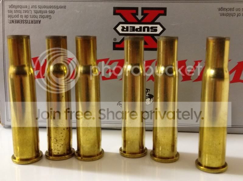

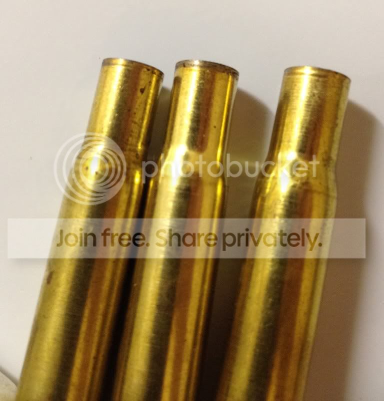

I will post pics of a few casings that are not cracked.

The shoulders look too rounded out to me.
Compare one of the empty casings to a new round if you have one left.

the shoulders of the fired stuff do look a little round, but looks and photos can be deceiving. I had 4 pieces of .303 brit do it on some new old stock Winchester ammo. I shot 3 boxes that day and only those 4 split. I say it was the brass being brittle.
You can also put some calipers around it, and measure it compared to the readily available case specs. It should not be excessively larger. I am no expert, so help me out you old hands.. I am guessin no more than a few thousands larger after being fired, as comapred to new.
Case stretch would be indicative of trouble, as well as a bulge that may be apparent if rolled across a flat surface such as glass. Look inside the case with a little light and check for stretch near the base while you are at it (which would also probably have a matching ring of some degree on the outside also). Some use an 'L' shaped probe to scrape the inside to check for this stretch ring, feeling for the telltale depression.
This is all academic of course, as your problem seems to be the shoulder (as someone suggested, some ham-handed novice gunsmith may have polished it out), or perhaps brass quality. Shoot some more rounds from a different manufacturer or production year if you can. See what happens.
