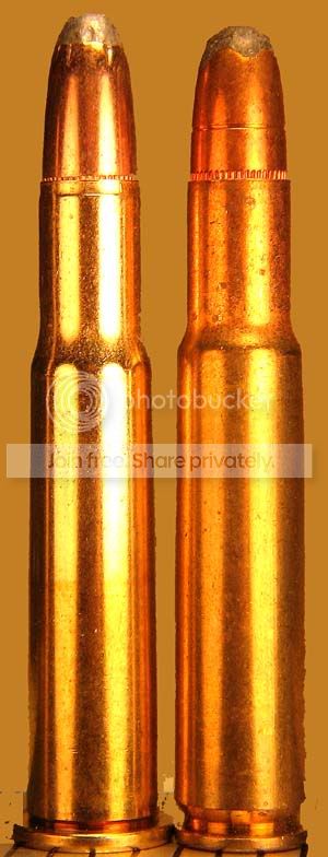

The shoulders look too rounded out to me.
Compare one of the empty casings to a new round if you have one left.
IMHO this is more than likely caused by one of the things I mentioned in my first post:
1) Someone decided to polish the chamber (possibly along with the action) and in doing so they rounded it out.
2) Correct me if I'm wrong, but afaik if there is excessive headspace (the gap for the rim with 30-30) the casing doesn't shoulder fully in the chamber and stretches, because the round is sitting further back at the bolt. I've not seen casings from an excessive headspace 30-30 rifle so I am not familiar with what they would look like.
You could compare these casings to another brand/box and see what you get.
I would just be careful of excessive fouling in the chamber from the cracked casings.
But that's just it; in a cartridge that headspaces on the rim, the shoulder does not necessarily contact the chamber.
