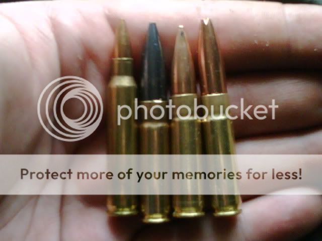

I have a crappy cell phone pic of some 'dummy' .300 Fireball rounds (no primer/powder) I worked up just for looks - let me get it uploaded and I'll put up another post.
-M
Here are three 'dummy' rounds (projectiles seated with a hammer... yes, a hammer - these are just for looks, until I get my actual dies).
Left to Right:
1 - .223 Remington, 55gn FMJ
2 - .300 Fireball, 168gn Sierra MatchKing (Moly)
3 - .300 Fireball, 147gn M80 Ball Projectile
4 - .300 Fireball, 165gn Sierra GameKing
the cases need a squaring of the neck after the stretching, but people were dying to see loaded rounds and this was the best I could do for now. I'll prime a batch of cases, then take 'em out to the range with my Lee hand press and a few different powders/a scale/a funnel to work up some loads.
