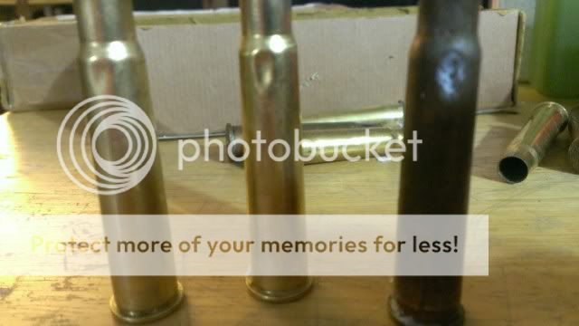

Too much case lube.
Vent hole?
Is this reparable? Or have these cases had it?
If you have the sizing die just touching the shell holder, you are full length sizing the cases. This puts a lot of stretching on the cases and your brass will not last very long. It will also cause the brass to seperate, and you will get a broken case stuck in the chamber.
Most of us who shoot .303 keep our cases segregated for individual rifles, and we neck size our cases only. This gives a minimum working of the brass and the cases last MUCH longer. Try your cases in your rifle, and if they fit, then do not full length size them.
What you have on your cases is a typical "lube dent" where excess lubricant inside your sizing die is forced up against the walls of the die and has no place to go, except to the weaker brass case. As mentioned, clean out the inside of the resizing die, then lubricate sparingly. Use a proper reloading sizing lubricant, not oil, or other compounds.
To neck size, there should be about 1/10 inch space. Go to a auto parts store, or a farm supplier and get a BRASS spacer washer, about 100 thousands of an inch thick with a 7/8 inch hole in it. Simply put it on the threaded portion of the die, and screw the die into the press. That way, it lifts the die up to provide a bit of space and you can neck size easily. When you get some range pick up brass or brass that will not fit into your chamber, you take off the washer and screw down the sizing die to full length resize. This way, you do not have to change the ring up or down, but merely use the washer of do not use the washer depending upon what type of sizing you wish to do.
Also, military .303 rifles are usually generous with their headspace. You can put a small rubber "O" ring on a brass case just ahead of the rim, close the bolt and fire the round. The rubber "O" ring will keep the rim back against the face of the bolt, and when the case expands to fill YOUR CHAMBER, you then have cases that are perfectly formed to fit YOUR INDIVIDUAL RIFLE and these cases will headspace against the shoulders of YOUR chamber. You can then neck size only enough to hold the bullet in place.
LEE sizing lubricant is a good one to use. But, use it sparingly - just a small dab then rotate the case while holding your fingers on it to spread it around. A ery thin film is all you need. This LEE lubricant is actually a lubricant that the metal industry uses to form metal parts with and not give a lot of friction.
