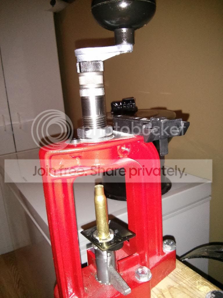

Thanks! I have been reloading .45 for a couple years, but this is my first attempt at rifle. I neck sized the once fired brass and FL sized the rest. I am using this new lee case trimmer and I love this thing!!

Does it stop cutting when you reach trim length or do you have to measure it manually?
It does. Cuts right down to 2.015". The black dial on the handle can be adjusted to get another .006, if memory serves. Mine doesn't have the added chamfer attachment, and I am kicking myself for not getting it. Mine just cuts (I can add that portion later). The cutter portion is universal, you just have to buy the "die" for your caliber.
