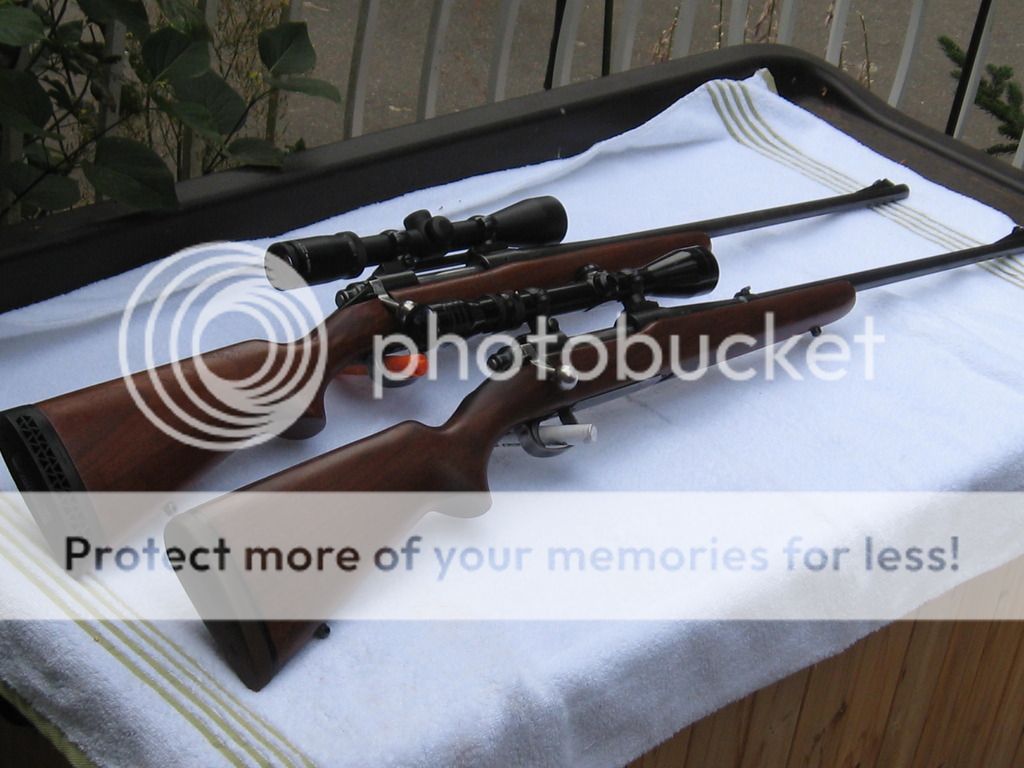

Here are my two, 300 H&H is the top rifle, 308 Norma on the bottom..
