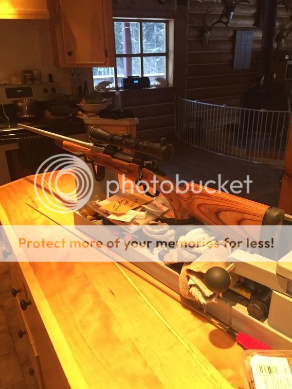

Thanks for all the great input on this thread. This one took a little longer than I thought it would. Nobody's fault but my own though...I just kept hummin /hawwin over whether to re-chamber that B78 and maybe end up with something that wouldn’t do what I wanted it to do. And lo and behold... the perfect thing showed up to help me make up my mind. A Montana LA LH in a good stock and and in great condition
So..on went a new Jury bbl 1-10 twist, chambered and installed by Custom GunWorx and off to the range I went. All the mechanical portions on the rifle worked perfect but....I couldn’t hit the broad side of a barn!!! It took a bit of head scratching, a couple of checks, 18 rnds of ammo (I'm stubborn) and I couldn’t believe it but my S&B scope "crapped" on me
So on goes a spare VX-1 and yea....this thing shoots !!! It shoots real nice

And I'll be damned if I can figure out why that image is loading sideways...
