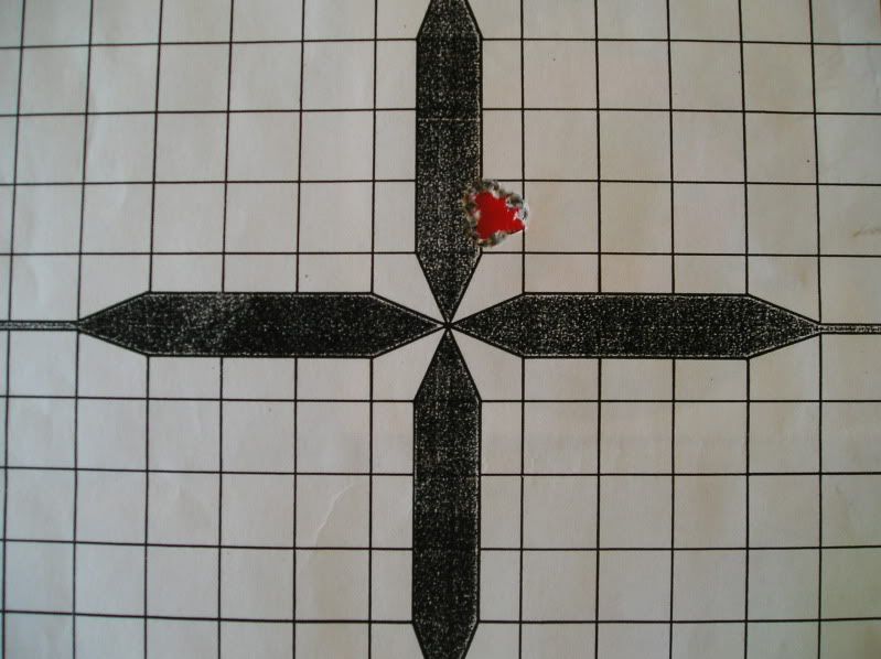

At 100 yards I can hit .710 @ 100 meters with a factory rem 700 sps in .308
In my Remmy 700P I use 46.8 grains of Win. 748, Win. WLR primers, Win. cases and a 168g. moly coated Sierra Matchking HPBT. C.O.A.L is 2.820''. It shoots 1/2'' groups @ 100y. consistantly but is capable of better when I'm on my game:
hey man, good shooting :)
