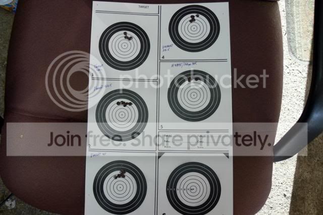

308win Varget & H 4895
Picked up a older Rem 700 HV 24" in extremely nice condition, got Ian Robertson to bore scope barrel throat and muzzle where excellent gun has not fired a lot.
I used to shooter Hunter Benchrest in .308win with 168gr Sierra MK and the load most everyone shot was 40gr - or + of H 4895 & Imr 4895 and some used IMR 4064 as well
Only had enough H 4895 powder to load 8 rounds to get on paper and fire 1 5 shot group, Fellow was telling me that Varget was best powder in .308 for accuracy
40gr & 168gr Sierras. as you will see in photo loaded 39.5gr, 40,40.5 and 41gr.
Varget did not work well in my gun, possible with more testing it could be good ? I know fellow shooting 155.5 gr Bergers with Varget ( full case) in a 30" barrel
at 3040fps and its very very accurate. I was wanting a soft load for 100 to 300y benchshooting.
first target above sighter target has 4 in one hole measured .070" and the one that got away.
