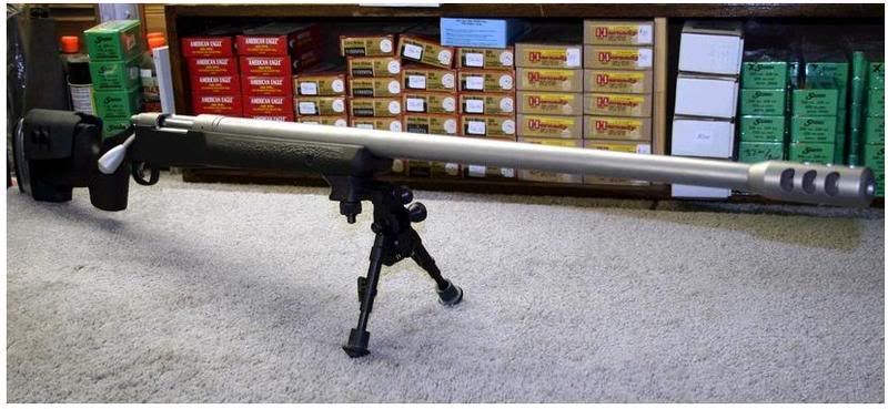

here mine sitting on the infamous freezer,,,(hope u dont mind Rick )
im still waiting to fund a rail and a scope for here ...but have bin forming brass
in the mean time for it ....:)I have the 300Rum brass necked up to 375 Rum
and will be seting up a false shoulder on it and let em rip sum day ...
