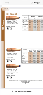

Took my newly rebarreled gun out and fired off 30 or so rounds just to get the scope dialed in and burn off some ancient powder. First impressions were good. Recoil was not as bad as I thought it would be. Gun shot decent groups with the old powder. Just had an issue with extraction. Need to address that before furthering the load development. This will be my moose and deer gun this fall.
Best 338 Federal group I shot so far. After going back out 2 weeks later with the same 47.0 grain load I couldn't get under a .7 inch group. Temperature was around 0 both days.
Gun is a Tikka T3 with McMillan Hunter stock. That will be the load for moose this fall, Priority 6 in AB.
