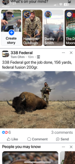

I have that Fusion Bullet loaded to 2700 from my T3 !
