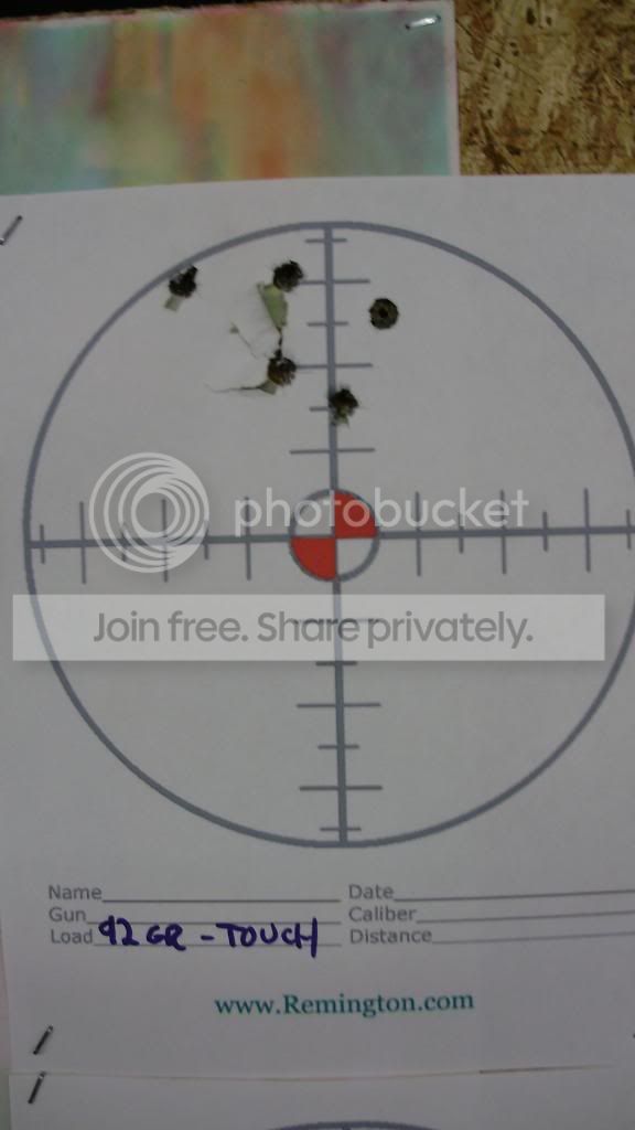

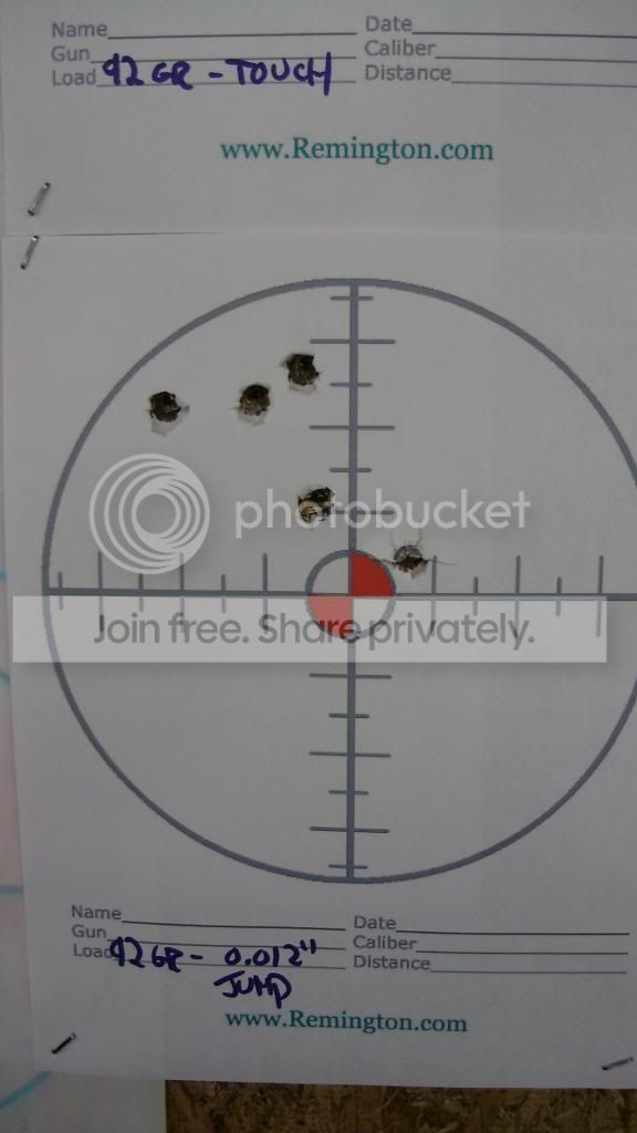

The next ladder test I would do if I were you would be 90.2, 90.4, 90.6, 90.8..... all the way to 92 in .2 increments using H1000. All at a 200 yd target. Thats were I am starting. All the reviews about our guns the sweet spot was in there. They also stated 15 thou off the lands was the winner too. Consistant case neck tension was a big factor with group size as well. I haven't found a 200 yd spot for load developement yet.

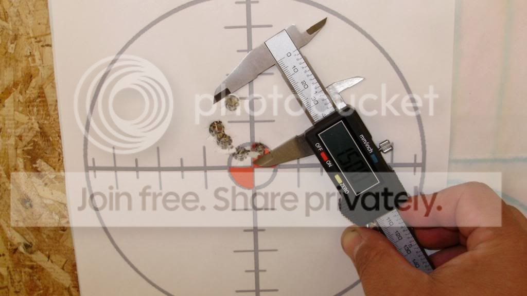

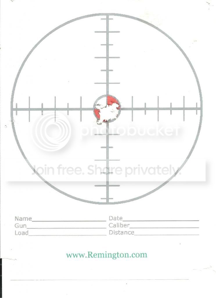

Ok, went out today with the SIII scope on top of my 7-08.
These tests were done only @ 100 yards.
I did a test to confirm tracking: Shoot and adjust to zero on each pair for a total of 8 shots.That looks good to me, actually impressed with the Sightron's tracking.
Also A 10 shot rapid group.This is very close to the best 10 shot groups I had previous done with the same rifle with my Conquest scope.
Here are this mornings targets:
I think I will order some SMK's as the next step, I don't want to bail on the H1000 just yet for the .338.
