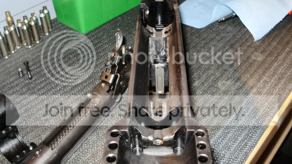

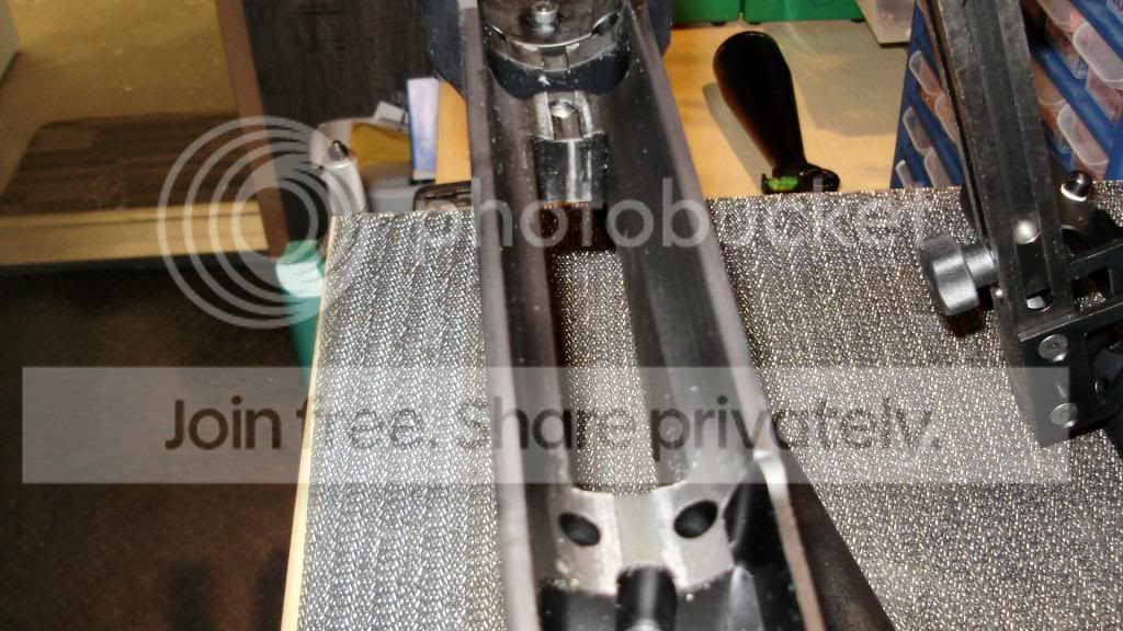

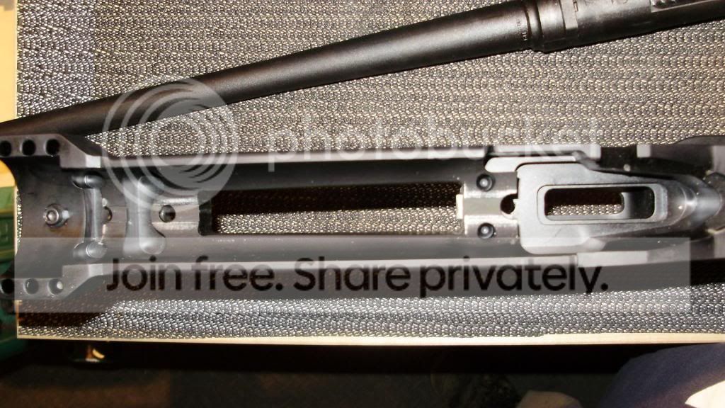

Here is the chassis system sans the action:
IMO it does look like the lug was tight against the chassis but the recoil was causing it to rub at the very top as you can see the finish removed.
As we speak the bedding compound is setting up.
