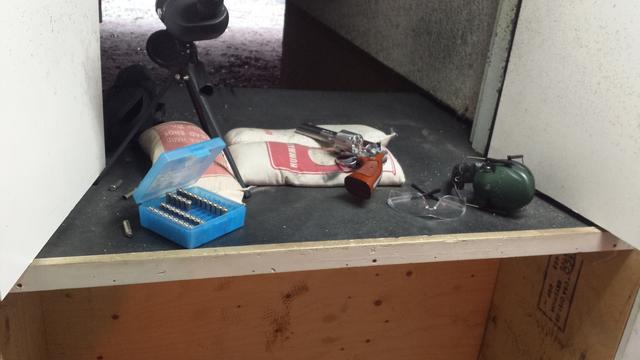

Finally had time to go to the range this afternoon and had lots of fun!
As mentioned I did load up 15.4, 15.6, 15.8 and 16gr and didn't notice a lot of difference between loads so I'll stick with 16gr for future loads.
No sticking of brass or other pressure signs.
